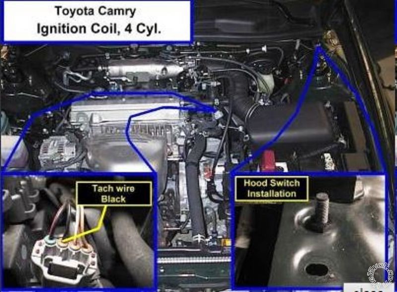

Here's the Tach wire on a 4 cylinder engine ( from ReadyRemote ) :
Viper 5806V to Camry 1999 -- posted image.
