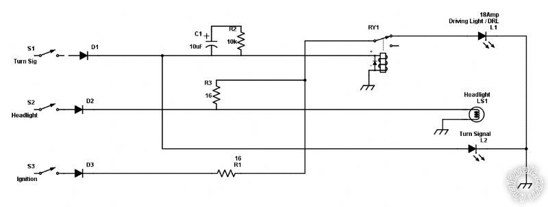

OK to preface I am a noob and have very little knowledge. What I am trying to accomplish is this:
Driving lights act as DRLs while ignition is on and then switch to driving light intensity when headlights are turned on. Also along with this I would like the DRL/Driving light to turn off while turn signal is active. I forgot to add the relay for the headlights on the schematic but it will be there. Please take a look and let me know if I am on the right track or if you have any suggestions. The DRL/Driving lights are 18a per light. This is a 12v system. There would be x2 one driver side one passenger side. Thanks in advance. Actually I'm not completely sure you can reduce voltage to LEDs to reduce intensity so any insight on that would be helpful as well. Thanks!
DRLs, Driving Lights & Turn signals -- posted image.
