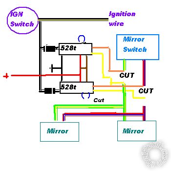

Hello, not sure if this is the right place but I am wanting to fit a pair of power folding mirrors, it is for. Peugeot 206. I have found the two wires that control the power fold motor but I am not sure where to continue. I would like the mirrors to fold out when the ignition is on and fold in when ignition is off.

Here you go, you'll need a pair of DEI (Viper) 528t timers available from Car Audio and Security, this diagram will give you fold with ignition off and unfold with ignition on.

That looks brilliant Howie, cheers for the how to guide. I tried to find that place, maybe stupid but I could only find U.S stuff.

I out to explain, I've used the correct wiring colours for the 528ts,
you need to time how long it takes your mirrors to fold/unfold, there are pots on these units to adjust the time, add one second to each.

You will need two.
