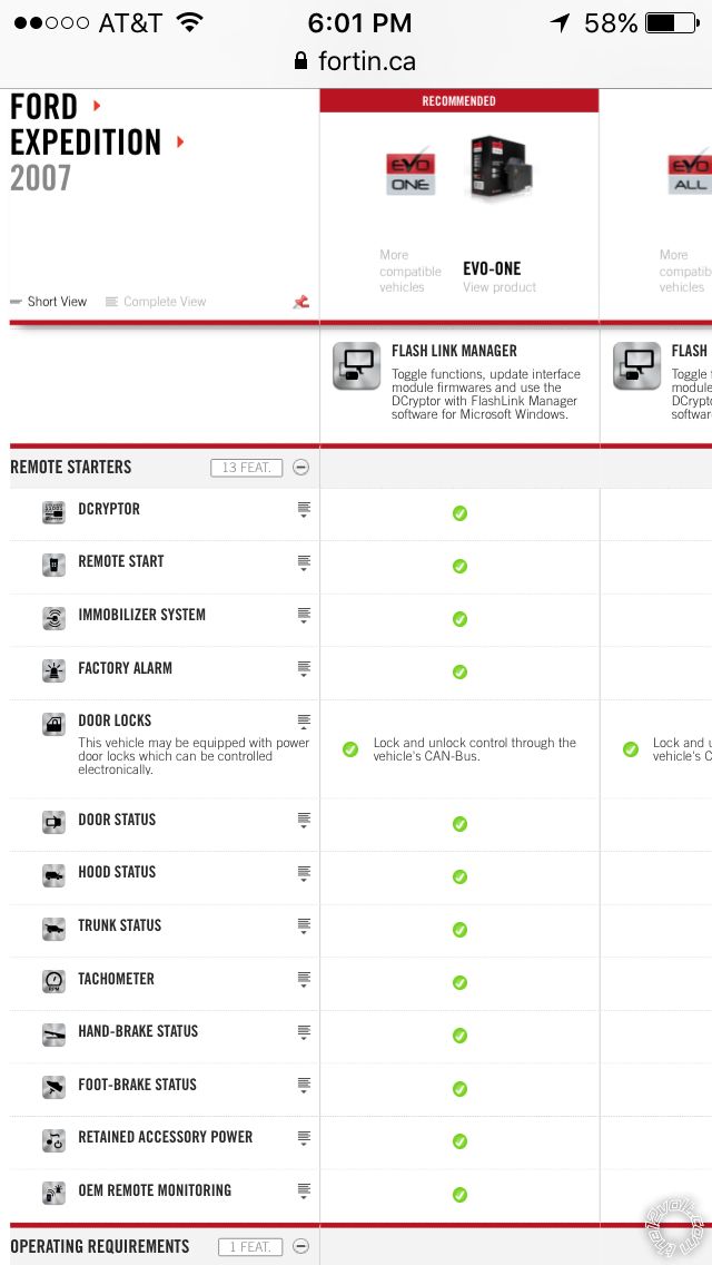

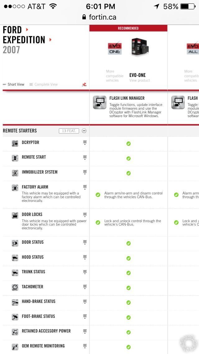

2007 Ford Expedition remote start -- posted image.
I apologize. Fortin lists it as can bus but if you open the manual it says otherwise. Connection MUST be hard wired. My apologies. Very misleading.
