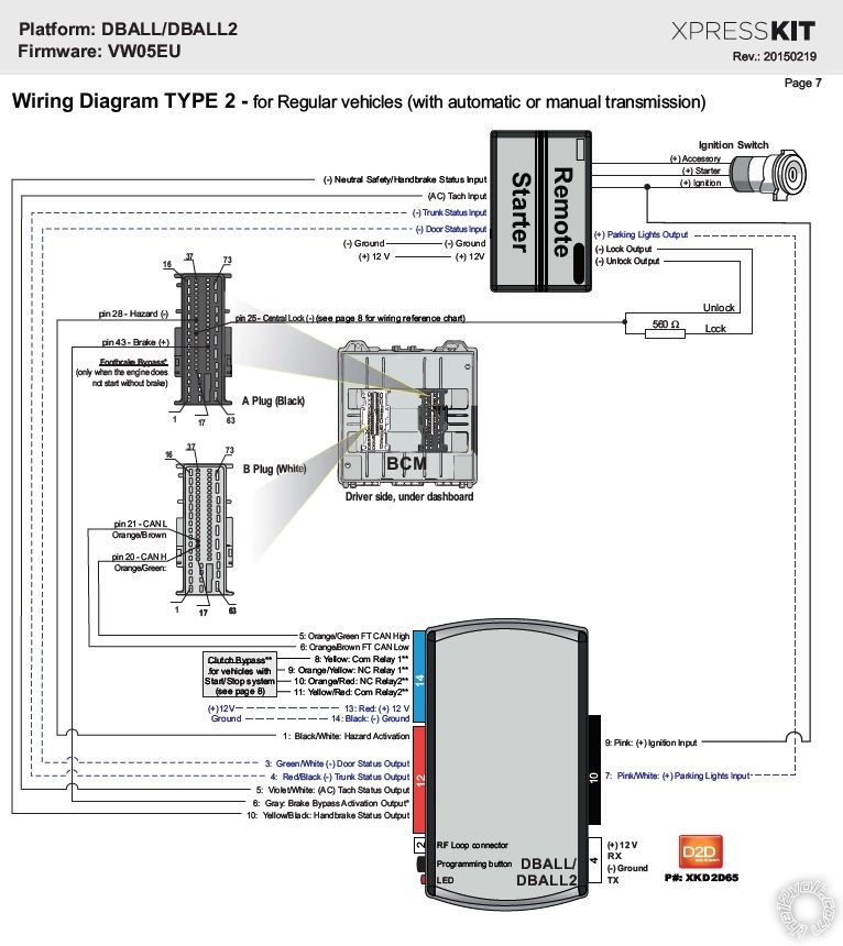

If you hardwired to vehicle and didn't use any kind of interface bypass.
This is for reference for some of wires that need to be connected to vehicle!
*Make this connections only for vehicles with Automatic Transmission
   Footbrake Bypass* (only when the engine does not start without brake)
**Make this connections only for vehicles with Manual Transmission
Scytek Galaxy 5000RS-2W alarm problem -- posted image.
Amarok (-) Hazzard A Plug-Pin 28 BROWN / Black
       (+) Brake* A Plug-Pin 43 BLACK/ Gray
       (-) Key Lock (for type 3C) A Plug-Pin 24 BROWN / Blue
       (-) Central Lock (for type 4C) A Plug- Pin 25 BROWN / Red
*Connect this wire only when the engine does not start without brake.
