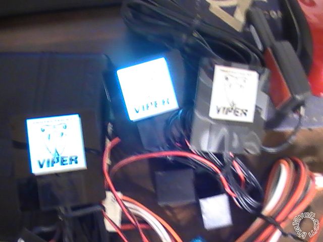

You can connect more than one of these to your system. You will probably have to follow the wires further back.
The red connects to 12volts and the black will connect to the Ground When Armed Output.
Crappy photo of three connected at the same time.

I've done two many times, front and rear, as Smokeman says, 12V+ constant source and GWA.
