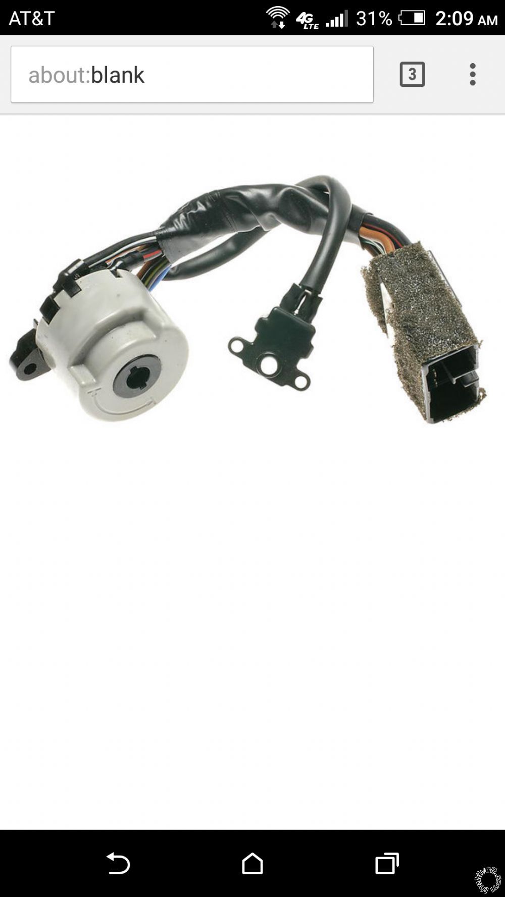

(Final UPDATE) I finally figured out the problem with the old 94 LS. the tach signal behind the instrument cluster worked perfectly and no hood pin was needed. All of the wires were connected properly to begin with. The system is set to tach sense for the remote start. Also, no bypass was needed for the security system. The problem was actually in the electrical ignition switch. Some of the contacts inside were touching where they weren't supposed to be which caused the starter to crank indefinitely. I was able to recreate the indefinite cranking by using a flat head screw driver to manipulate the switch in different directions once I removed it from the back of the lock cylinder. I took it apart and cleaned it and now my remote start works as it should!! Here's a picture of the part.
