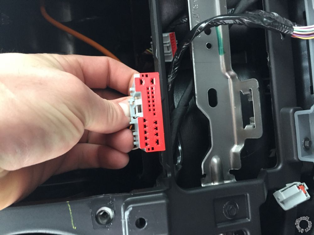

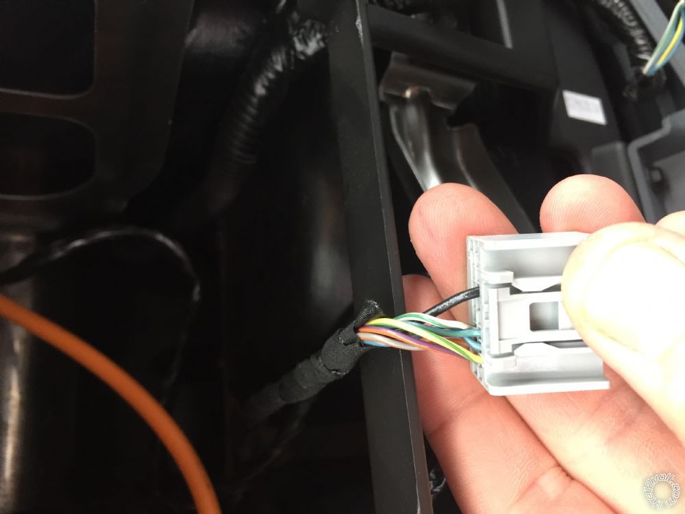

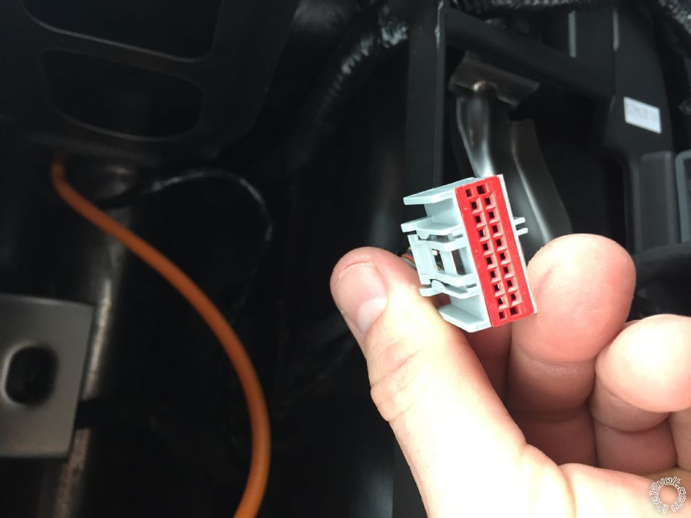

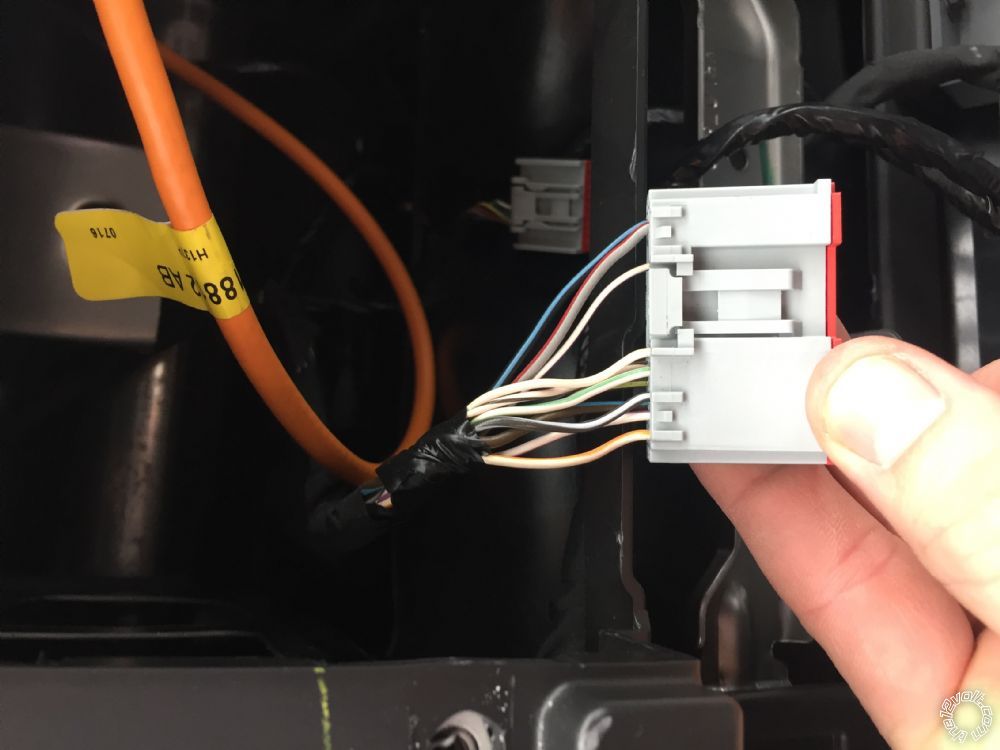

Need help with identifying these wires
Ford F-350 radio -- posted image.

Ford F-350 radio -- posted image.Ford F-350 radio -- posted image.

If you are trying to change out the radio look into purchasing a Metra 70-5520. You will have to find a switched power source because that radio is data controlled. If you do not want to have to find a switched power source, a Metra XSVI-5520 may work on that vehicle. Metra does not list it, but it should work.

I bought the Metra XSVI-5520 kit. It worked great. The only other thing you need to buy is the radio antenna adapter.
This was on a Ford F-350 2016 truck and a Jensen 7022 radio.
