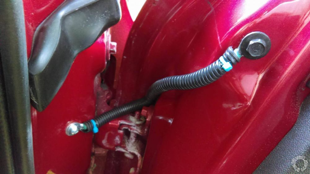

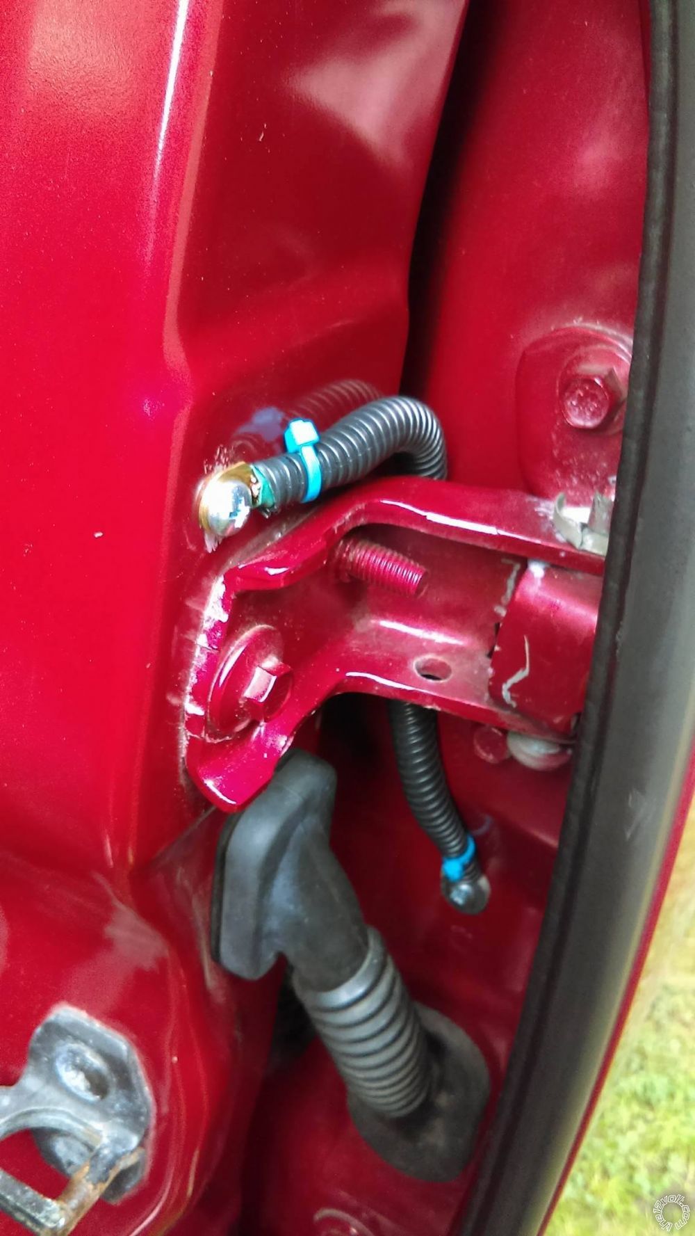

Posted: July 21, 2017 at 2:43 PM / IP Logged Link to Post Post Reply Quote apex315
Just a few shots of how I grounded the doors. What you see here is pretty much identical for the opposite doors
Posted: September 21, 2017 at 8:30 AM / IP Logged Link to Post Post Reply Quote howie ll
Totally pointless if you have a constant ground at the window switch or door module, also those screwheads will rust out pretty quickly.
