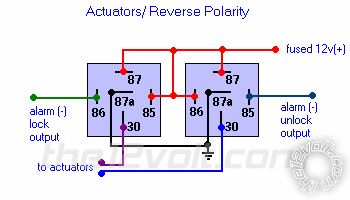

this is what I followed. but I just diode isolated it and it works fine now. was that a good idea or will I have problems in the future?

Just remove ground from 87a of both relays.

are you sure they are positive and not reverse polarity?
