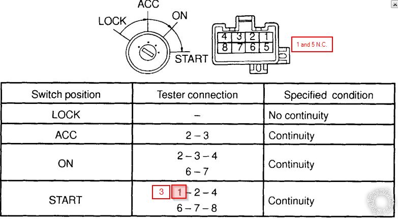

To provide additional information.. Aside from the "Tests as ignition" note I am also thinking accessory based on information from the Haynes manual.
The Camry uses an 8 pin ignition harness with 6 wires in the harness actually connected. Pins 1 and 5 have no wiring but the continuity diagram shows the Start position passing continuity between 6 pins. Problem is it indicates pin 1 that is NC so I am pretty sure they meant Pin 3 for accessory.
98 Toyota Camry Accessory Wire -- posted image.
Since it seems like feature programming is locked and I do not have a BitWriter - ill try the previous note tonight (crossing Ignition 1 out with Accessory out). In the event this works ill have to keep it wired this way until I can find a shop with a bitwriter who's willing to reprogram it.
