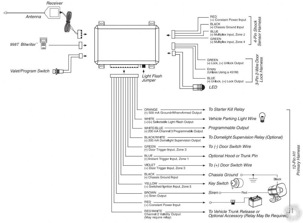

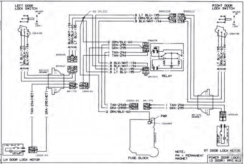

I have in my possession an older model viper keyless entry I was going to add to an old cutlass that I ended up selling. I would now like to install it in my 1980 K10 that has the 1985 power door locks for the doors.
Based on these diagrams can anyone tell me the proper wires to tie into on my wiring schematic. Also as for the started interrupt I believe I can tie it into the purple wire at the column mounted starter switch if this is incorrect please let me know.
Thanks for any help anyone may be able to provide.
Viper 3100VX Wiring -- posted image.
The above schematic matches the door locks I pulled from the 85 chevy truck and installed in my 1980 K10.

Posted: April 14, 2018 at 7:16 PM / IP Logged Link to Post Post Reply Quote geepherder
https://www.the12volt.com/installbay/alarmdetail/438.html
