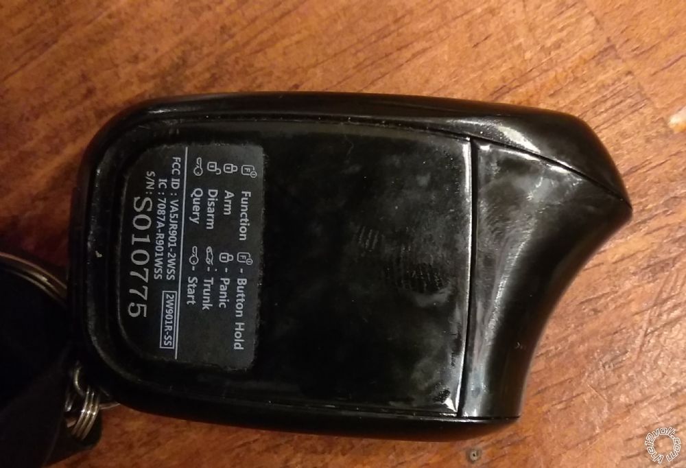

Lubrano, please post some detailed photos of your remote.
Compustar 2W901R-SS Battery -- posted image. the12volt • Support the12volt.com
Lubrano
Copper - Posts: 113
Joined: October 19, 2003
Posted: June 28, 2018 at 10:09 PM / IP Logged Link to Post Post Reply Quote Lubrano
Compustar 2W901R-SS Battery -- posted image.Compustar 2W901R-SS Battery -- posted image.
the12volt
Administrator - Posts: 3,959
Joined: March 07, 2002
Posted: June 29, 2018 at 3:03 PM / IP Logged Link to Post Post Reply Quote the12volt
From what I can see, it looks like the back panel might snap in.

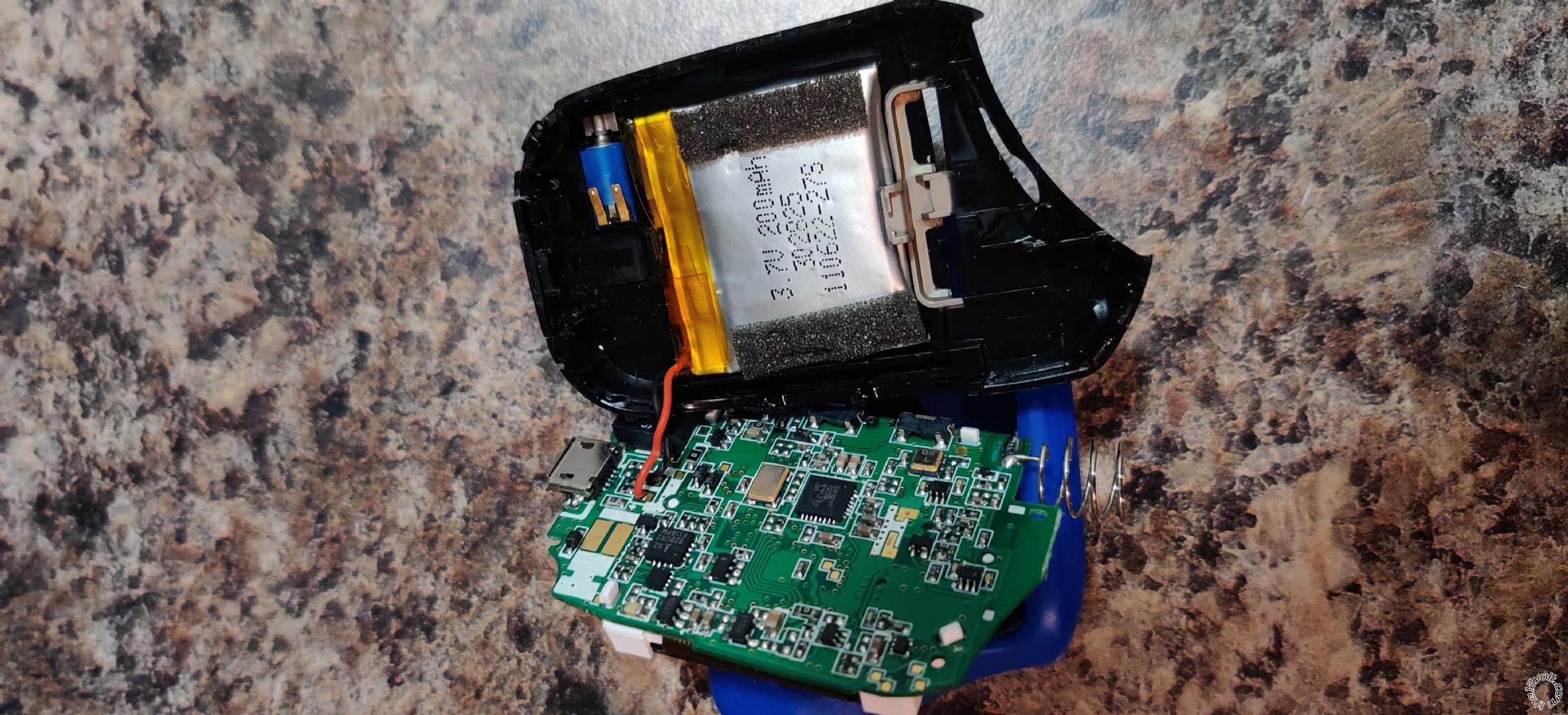

I just got a changing new Battery for my CompuStar.
1. Open the small Phillips screw located at charger connection.
2. Turn the back of remote. Using a flat screw and push down the Two lock and Remote the top.
3. Open Two panels out and Battery will be under the Screen.
I got a battery but it was a little thick. Therefore, it was a little hare to put everything back but finally, it was work.

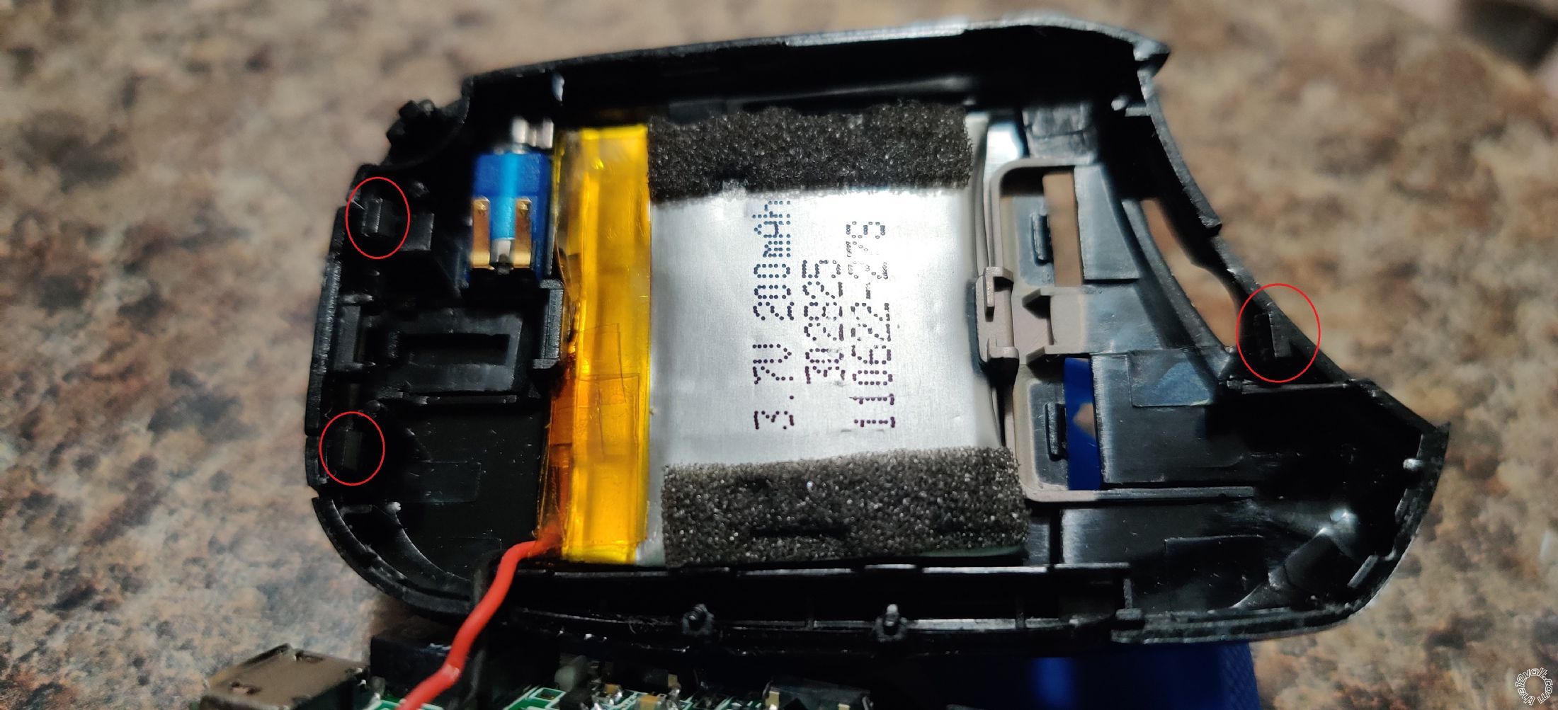

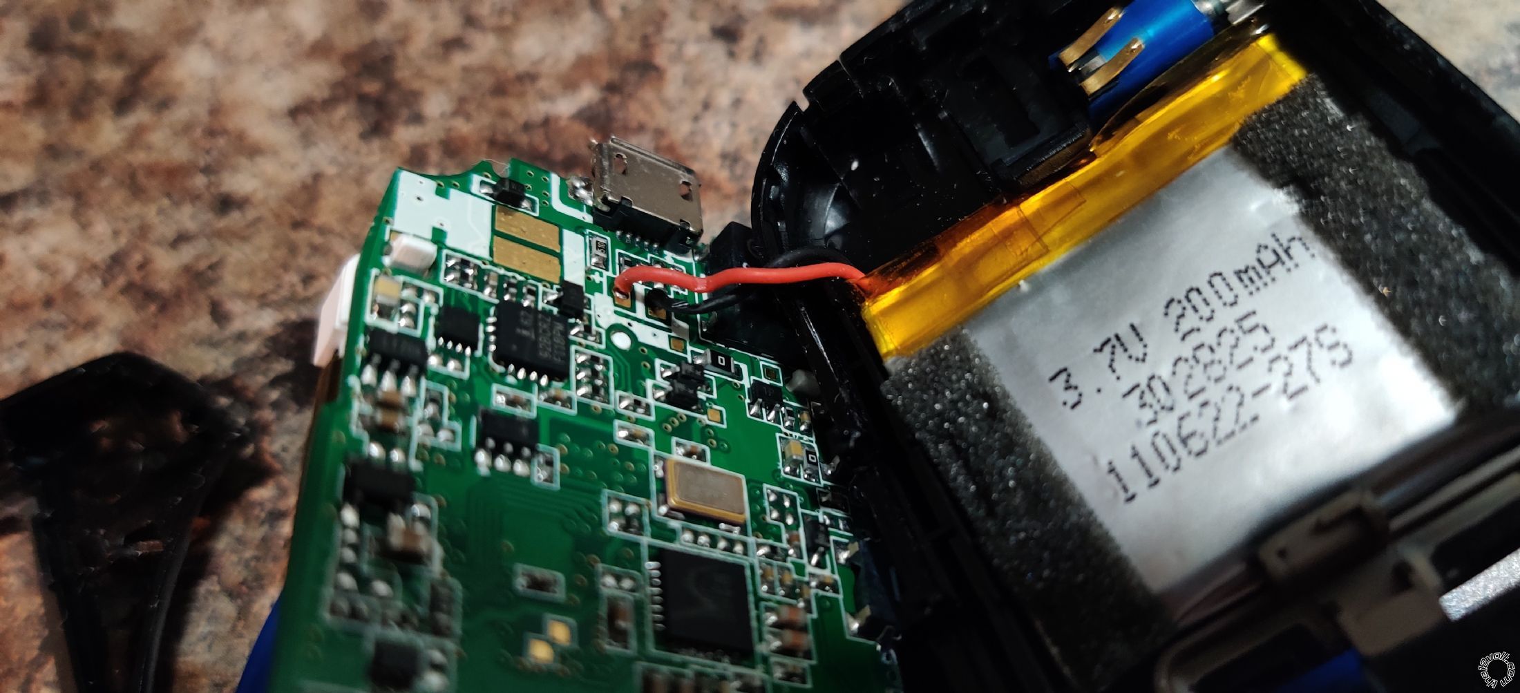

It can be done, but it's almost more trouble than it's worth. Taking the remote apart is a chore because of the three tabs holding the circuit board in place (circled in red). I was sure I was going to break one of them while trying to get the circuit board out. If you're lucky or skilled enough to not break one of them, then you have to de-solder the old battery wires and solder the replacement wires. The battery is 20mm x 25mm x 4mm, and you can get 300mah ones at Amazon or eBay.
The first steps are to pry off the plastic cap from the top of the remote (the swooshy part), and then remove the small Phillips screw right next to the micro USB connector. Separate the plastic shell into its two halves, and then very carefully remove the circuit board without breaking any of the tabs holding it in place. Once the circuit board is dislodged, you'll see the battery underneath and the two wires connecting it to the circuit board. The battery has adhesive keeping it attached to the plastic. Gently pry it off. Then de-solder the wires and solder the new wires. Reassemble in reverse order, and function test prior to reinstalling the circuit board into its 3-tab prison.
For the vast majority of people, this remote is one-and-done. 1 person out of ~100 will actually attempt to replace the battery. Of those who do, probably 1 person out of 10 will succeed without breaking something.
Best of luck...
