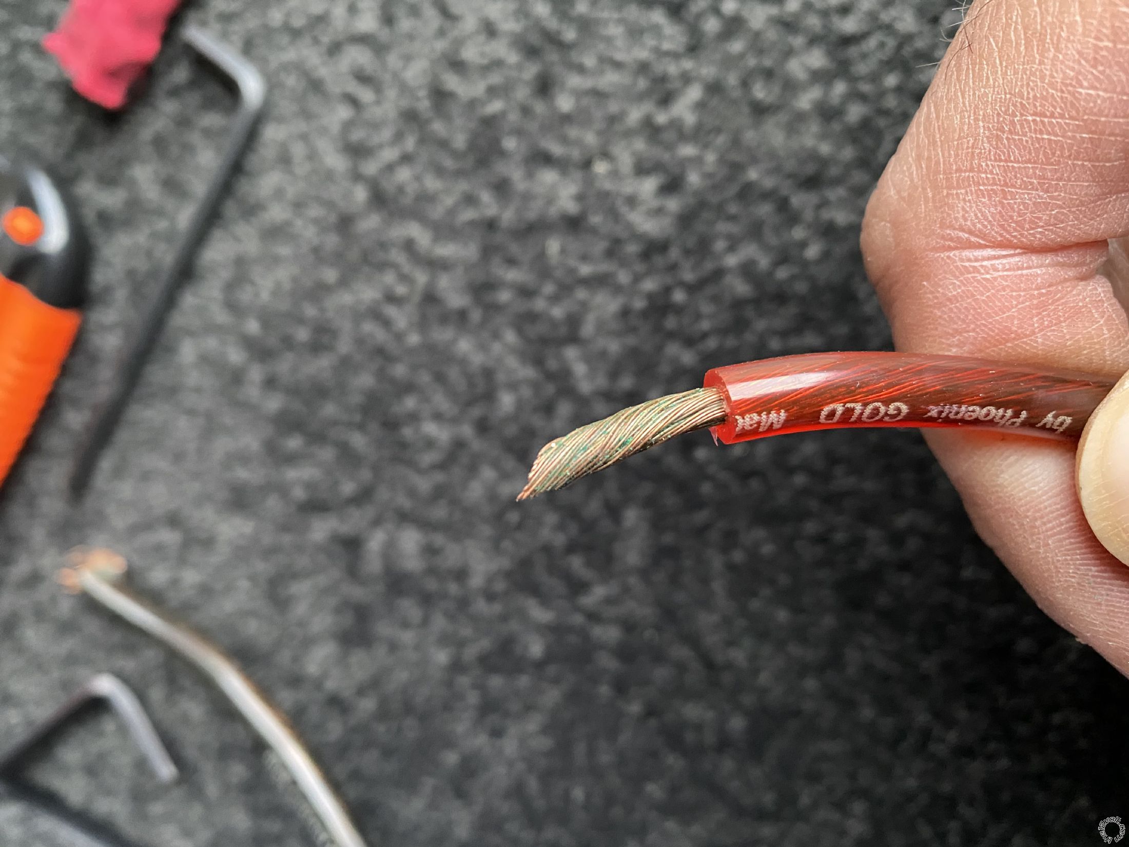

I did some further testing yesterday, I disconnected the main battery from the second battery just to test what would happen with the sound system running from only the second dedicated battery. The result was that the truck was still jerking when the bass hit. The only relation to the truck the sound system has with that set up is that the ground wire on the second battery is still connected to the chassis. The lights still very slightly dim (same as before) as well. Does this change anyone's opinion about the suggestions?
By the way, I also took the power wires out of the amp connectors since they were showing some corrosion. I decided to cut the ends, strip them back, and connect them again. I saw that both the ground and positive wires going into the amps are corroded. They are green around the outside perimeter of the wire. The center in pretty clean. The speaker wire appears to be similar from what i can see through the clear jacket but I haven't taken those apart and stripped them back. These are about 9 years old. I was thinking to replace all of the wiring perhaps and replaced the soldered "Y" connections to the amps with power distribution units while maintaining 4 gauge all over and eliminating the 8 gauge. See image attached of one of the positive 8 gauge wires going into the amp. Could this be causing a problem? The ground wire to the chassis looks good however. Vehicle Jerk to Subwoofer Beat While Acceleratng - Page 2 -- posted image.
