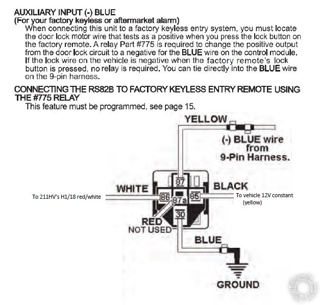

But you made me second guess the AUX on the 211HV. From the install manual of the RS82B, I altered the relay wiring diagram -- did I get it right?
Viper 211HV and Bulldog RS82B in 01 F-150 SuperCrew -- posted image.

Looks like I was slightly wrong with the 211HV's correct Trunk Release Output wire. It is indeed the Red/White wire
at H1/18. And yes your relay diagram will work but...
Standard relay convention has the relay coil Pin 85 getting the (-) input signal and Pin 86 getting the (+) input signal.
Reversing them as shown on your diagram usually will not cause any problems unless the relay has a built in coil
quenching diode. In that case the Pin 85 and 86 polarity must be observed. Also note the last two sentences in the R/S
wire description. The relays purpose is to change the typical (+) Lock pulse to a (-) signal that the Blue wire needs
to initiate a R/S sequence. While you are not using a vehicle Lock wire as the input signal, the 211HV Trunk Release
output is a (-) signal that the R/S system is looking for. It should function properly without the relay, just a direct
connection.

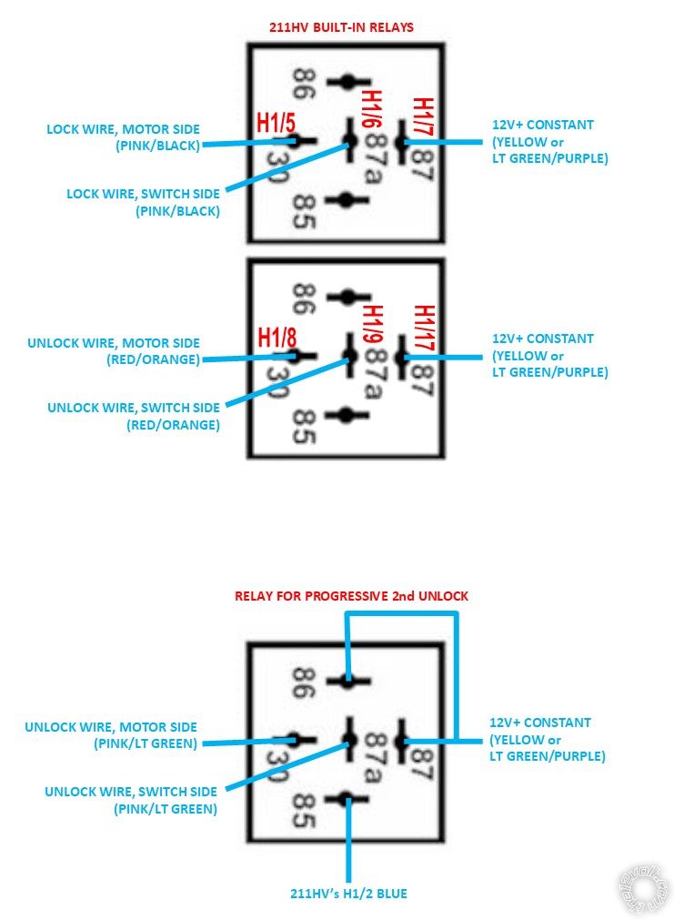

Would I assume on the cut lock wires -- the half going towards the door is the motor side of the wire?
Do I understand this correctly:

In your response to the RS82B relay...I assumed with it only being a 200mA source that it needed a relay to juice up the power to the RS82B blue wire. I would prefer to use the least number of relays, so then I'll connect the 211HV's H1/18 red/white wire directly to the RS82B's blue wire. Thanks!

The lock relay wiring is correct. Here is one way to determine the Motor or Switch side of the cut Type C lock wire :
Easy way to tell which side of the cut wire is the switch
and which is the motor, is to cut the wire and then press
the button. If it shows 12v it is the switch side of the
button you just pressed. Sometimes it isn't always easy
to tell which end goes to the switch and which side goes
to the car.
Remember to fuse the external relay's +12V supply power.

You are correct that adding a relay to the Trunk Release output will give it a better/stronger signal than the 211HV's 200mA output
and depending on the RS82B's needs might be required but I believe the un-enhanced 200mA signal should be sufficient.

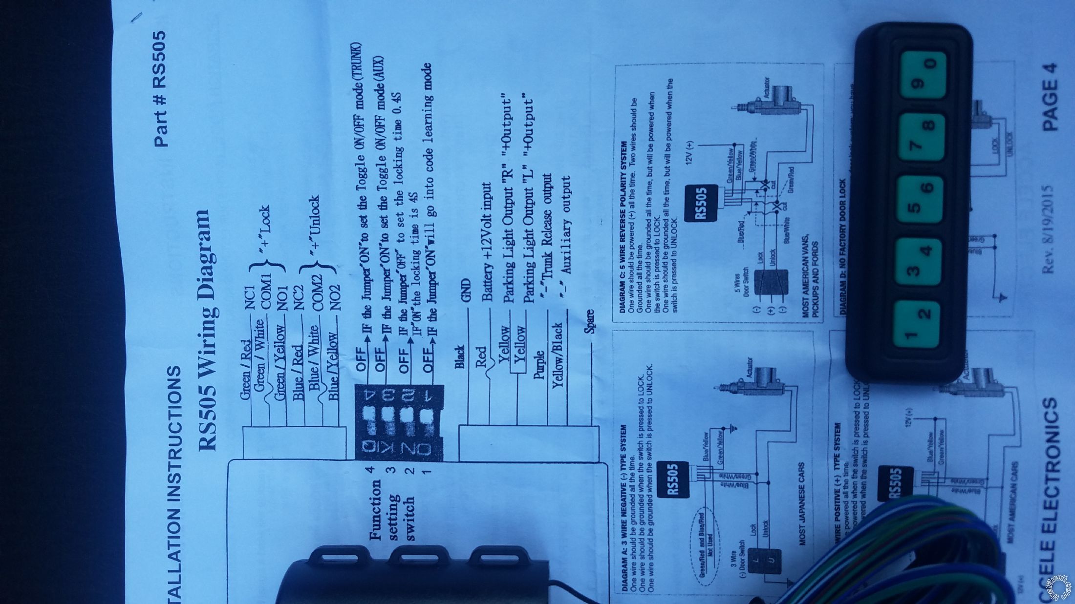

Posted: August 04, 2018 at 5:10 AM / IP Logged Link to Post Post Reply Quote rlwolfgram
I totally forgot I had this. It's a aftermarket door keypad like Ford's factory keypad. I bought it for a different vehicle I no longer have and found it when I was looking for a relay in a spare parts both.
If I wanted to throw this into the mix....the lock/unlock are relay connections just like the 211HV, right? Common is 87, normally closed is 87A, & normally open is 30?
