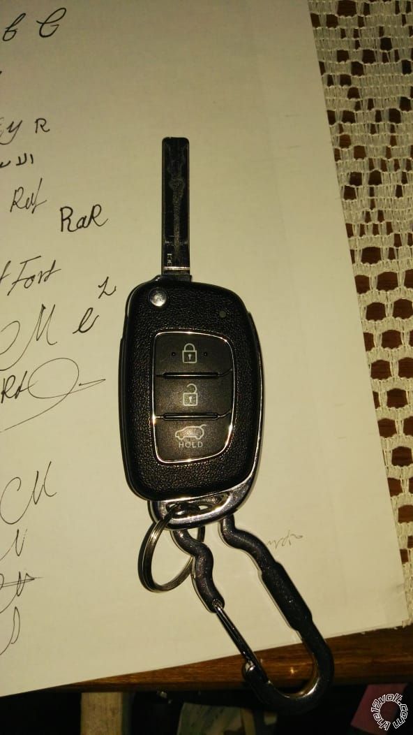

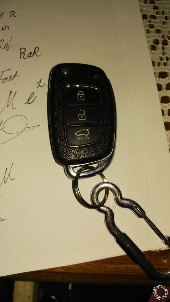

regarding your inquiry, the Key is not Push-To-Start it's regular ignition vehicle
i attached a picture of the remote
my question is how to determine if the vehicle needs a bypass module?

You can try the "foil wrap" test. Get a strip of aluminum foil about 3" wide
and 12 to 18 inches long. With the key open, wrap the remotes body with about
5 layers of foil. Ensure the key end is covered and sealed well with only the
key blade exposed. Try to start the Tucson. If it won't start, you have a
chipped key / remote assy. The best way is to actually look for EMS COM wire
in the Blue connector in the Drivers Kick Panel. Photo from Fortin below :
Immobilizer Bypass for 2018 Hyundai Tuscon, Viper 5704V -- posted image.
If the wire is present, you have a transponder system. If the wire is not
there and the pin location is empty ( third hole down from the top in that
front column, no transponder system.
