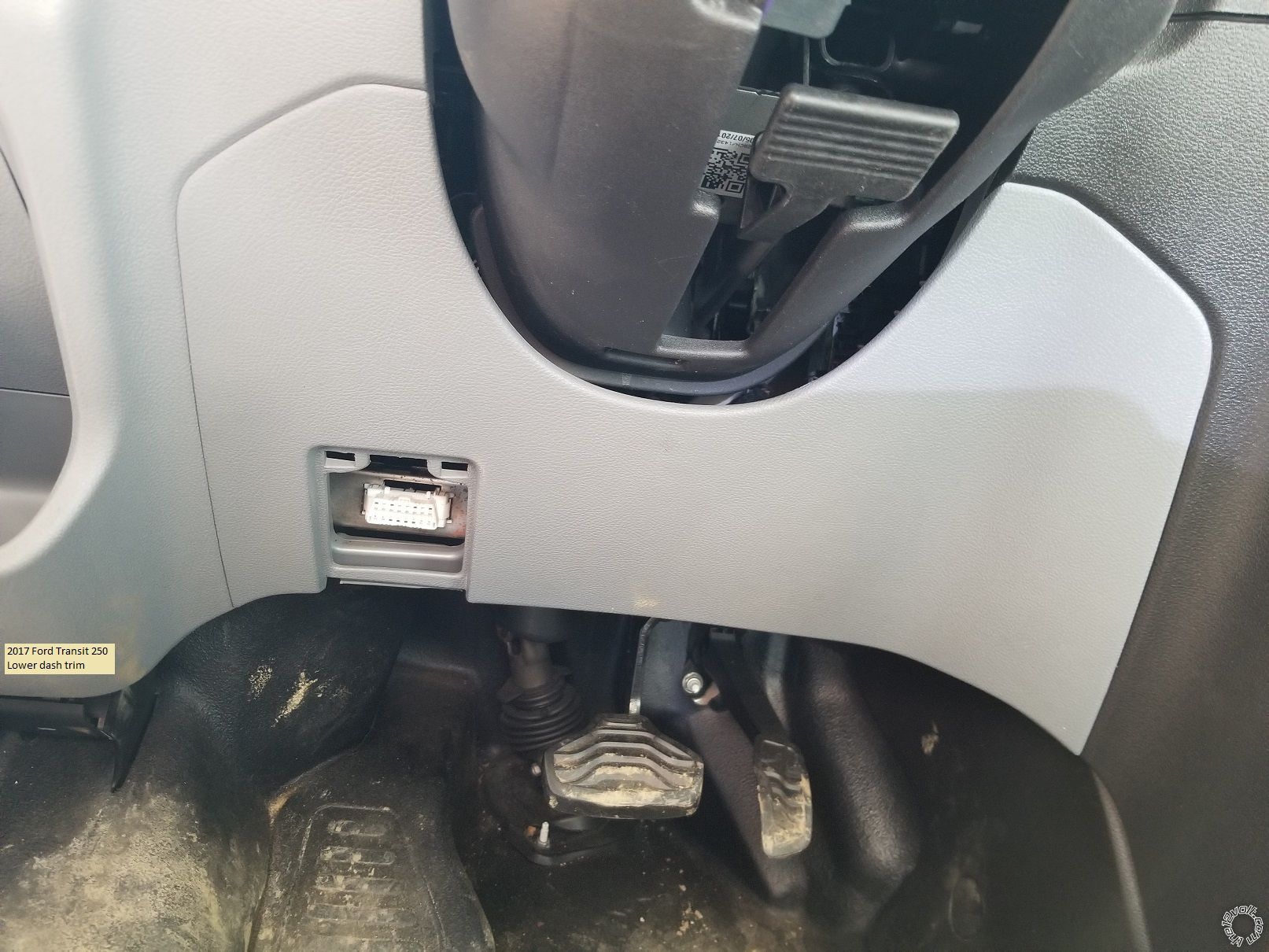

First pull the trim panel below the steering wheel off.

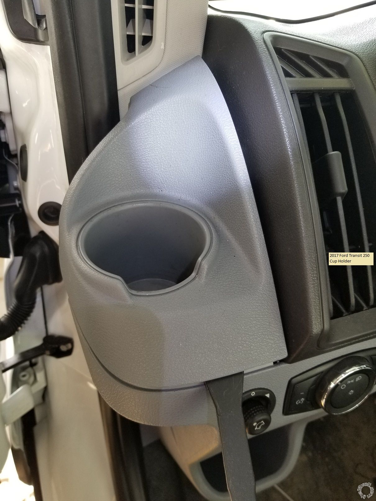

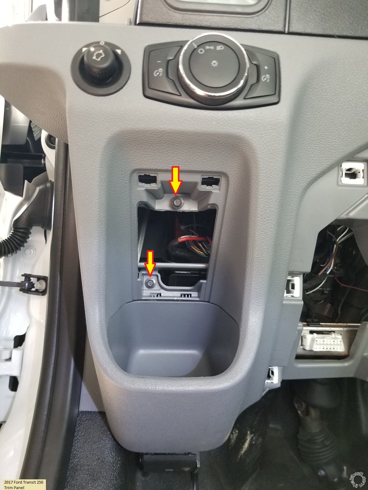

Next use a trim tool to pop the cup holder up and off.
2015-2018 Ford Transit Remote Start Pictorial -- posted image.

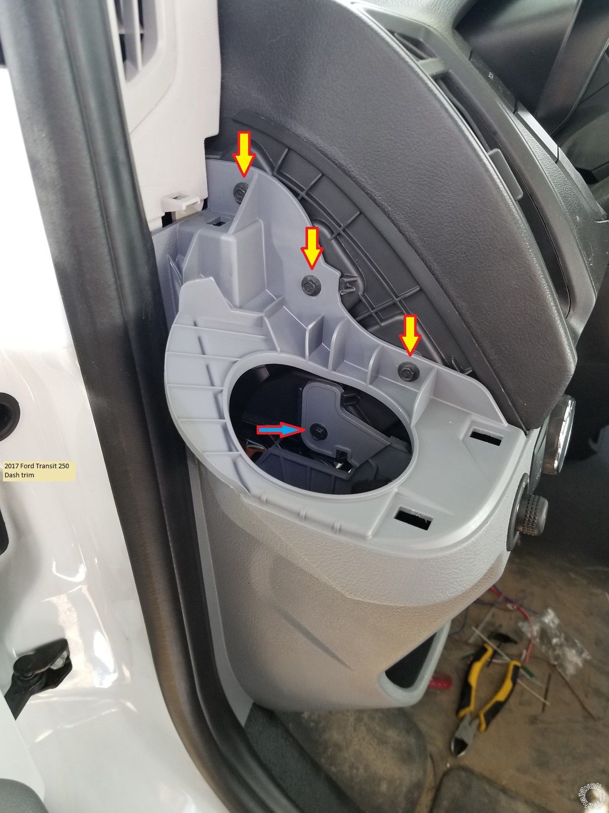

Use a 7mm socket to remove the three screws shown.

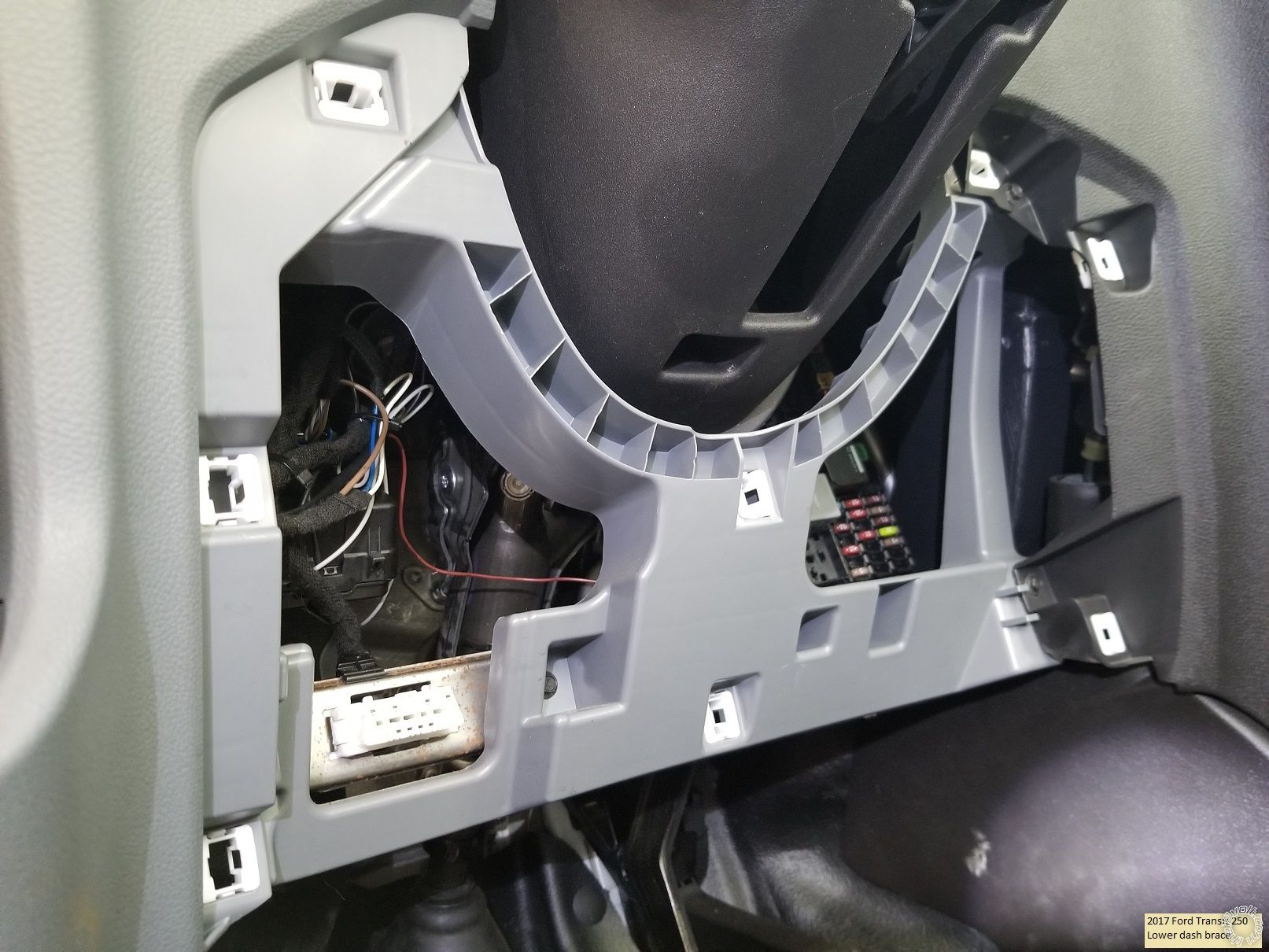

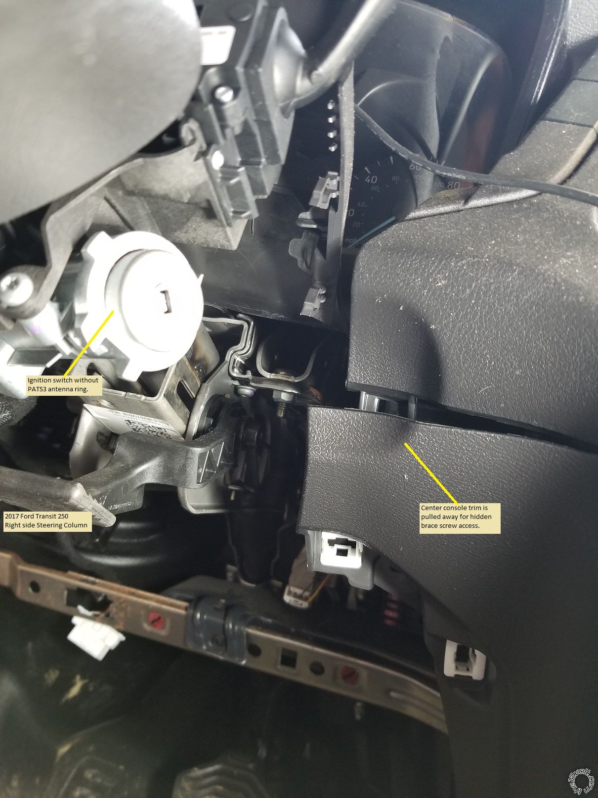

Release and pull this left side trim piece away from the dash.
To remove the inner brace panel, remove the seven 7mm screws. This is shown in good detail in the previously mentioned video. One screw is on the left side. You must gently lift the center console trim to access one hidden screw at the top right corner on the brace panel.

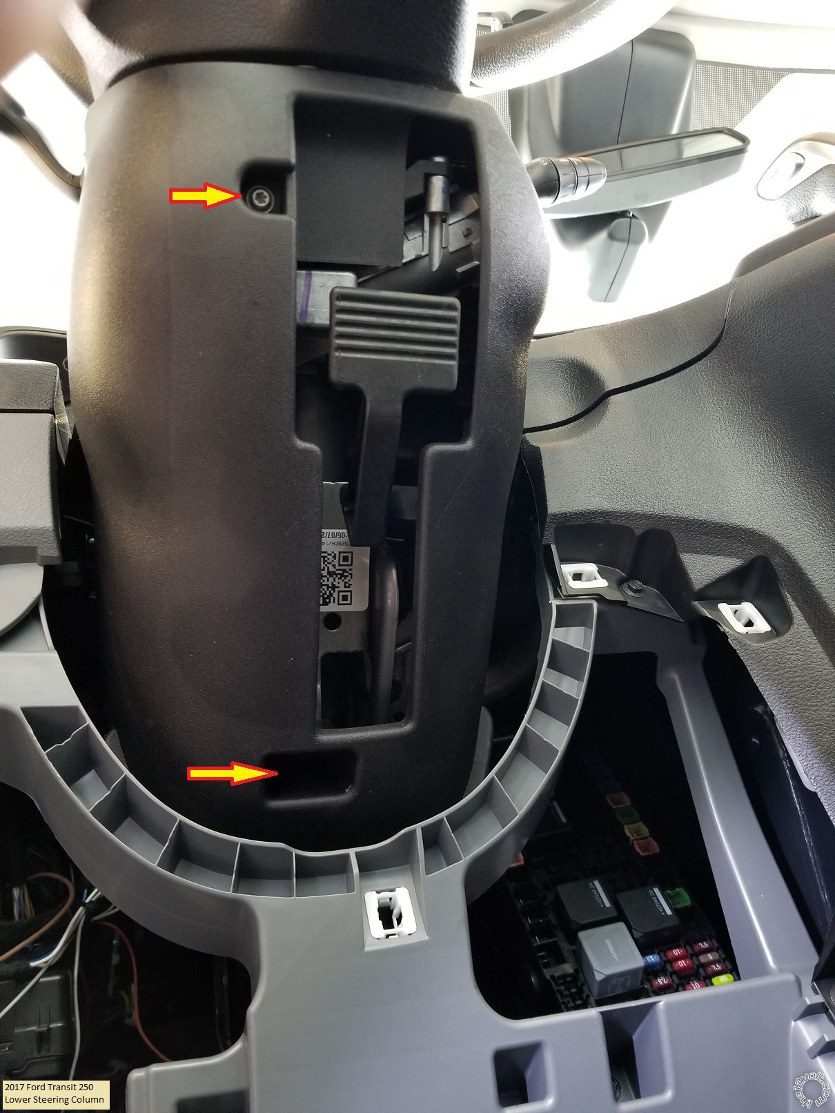

Remove the two T20 Torx screws indicated at the bottom of the steering column. Then turn the steering wheel to expose plastic releases at the 10 and 2 o'clock positions. Separate the steering column cover halves and remove the bottom piece.
That's it for trim removal. At this point you should verify that there is no black plastic PATS antenna and connector on the ignition switch. Below is a photo of this Transit without the PATS system. If you have the PATS antenna, you will need a bypass module.

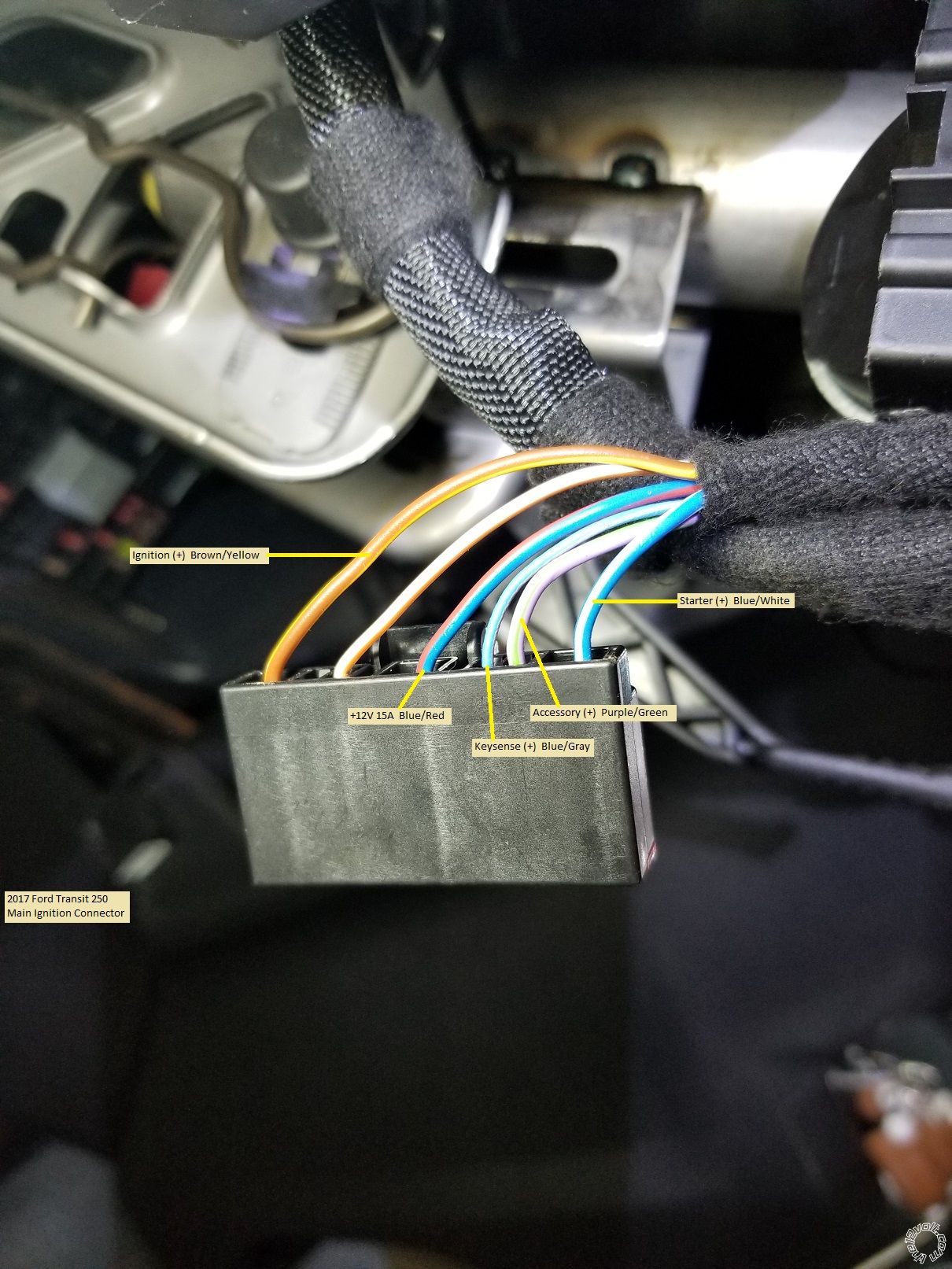

Here is a photo of the main Ignition connector removed from the plug with the wires marked. Only 3 connections are needed, IGN, ACC and Starter.

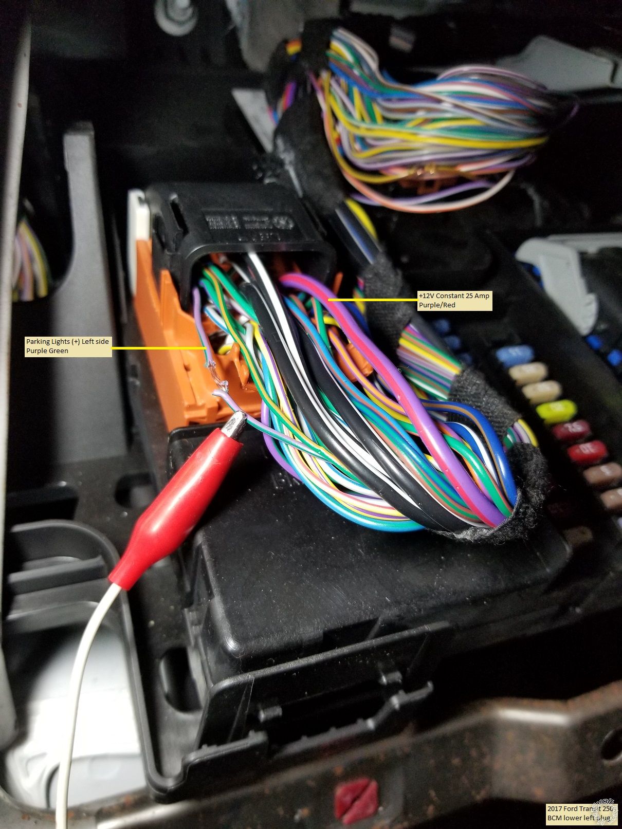

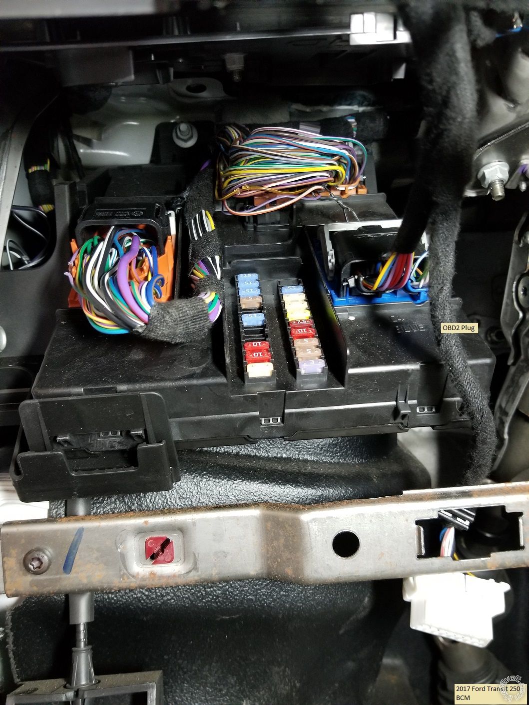

Below is a photo of the vans BCM located to the left of the steering column.
The lower left connector has the left side Parking Light wire as shown.

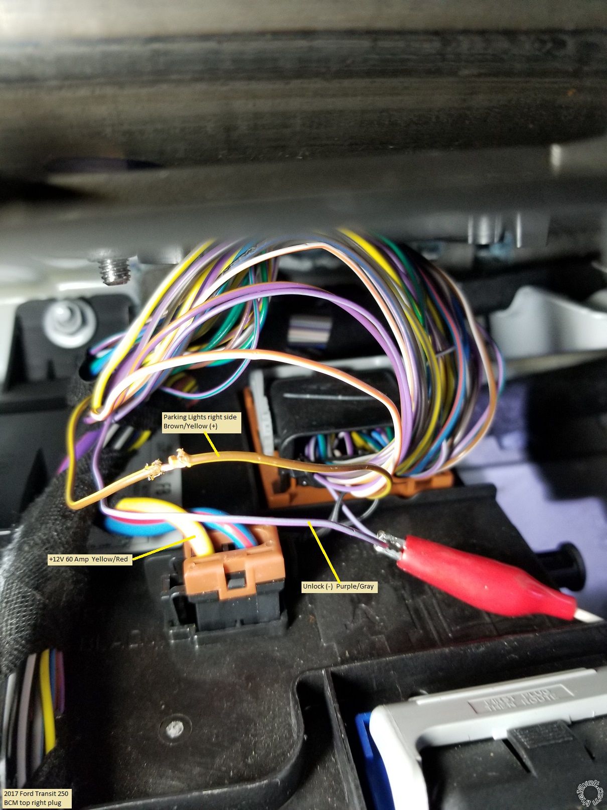

The connector at the upper right has two needed wires.

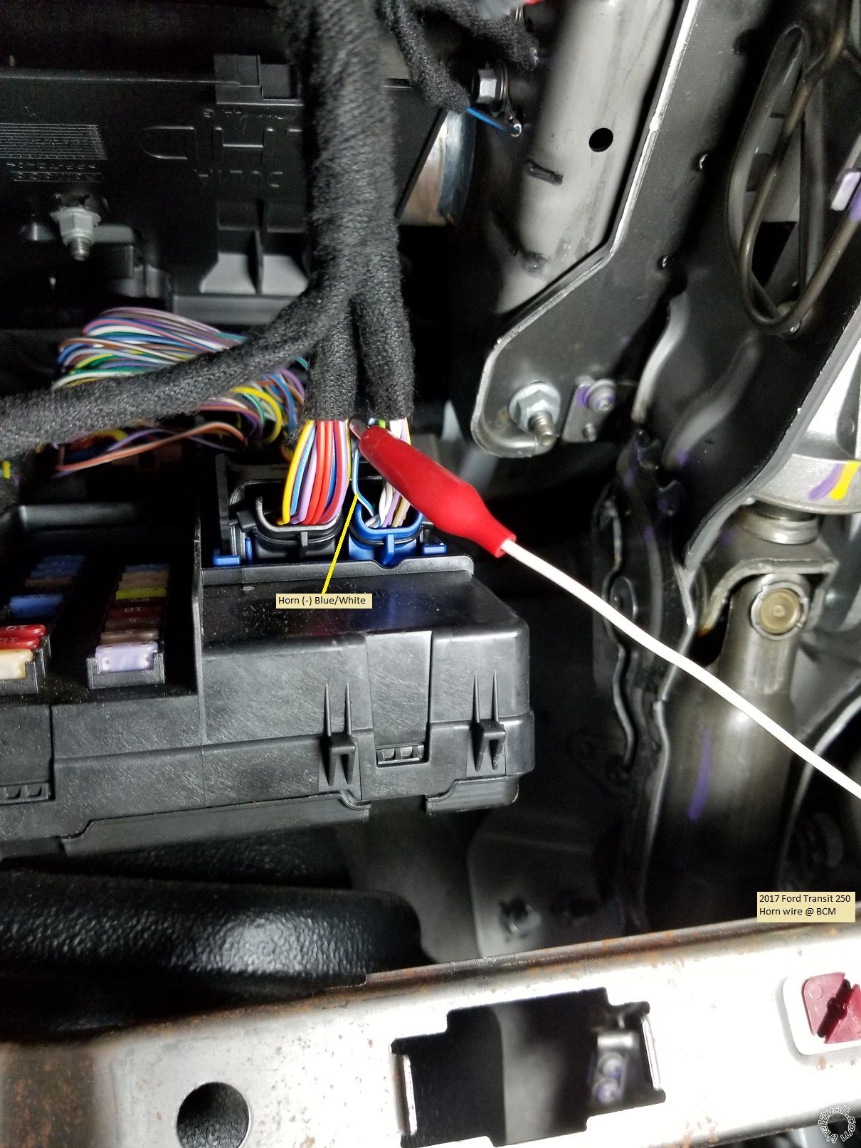

The bottom right plug has the Horn wire ( optional ).
As shown, +12 Volt constant power can be obtained from either wire indicated in the above pictures. With a basic Avital 4115 system and it's low power draw, using the Purple/Red wire is acceptable.

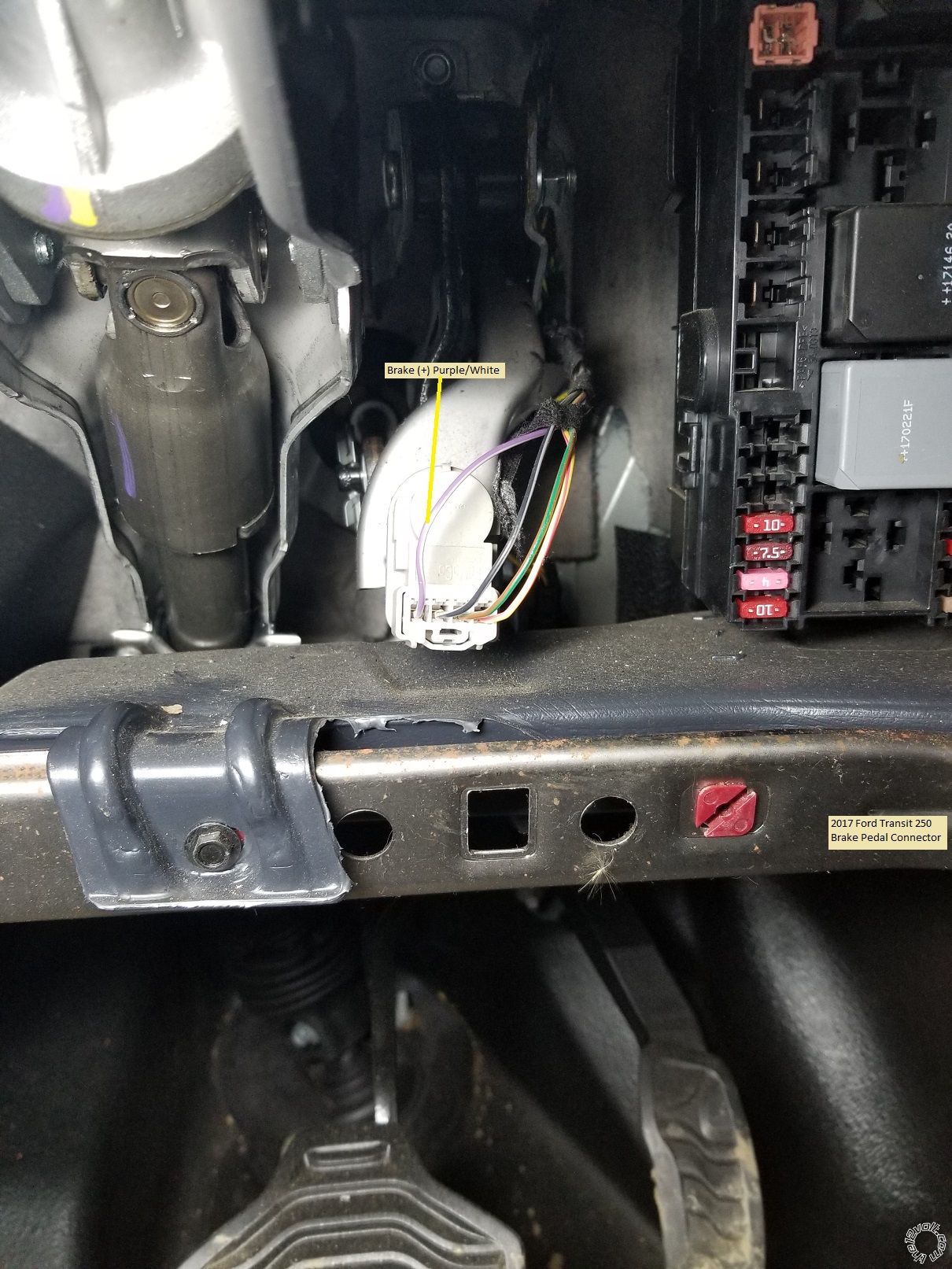

The Brake wire is easiest to obtain at the Brake Pedal switch as shown below :

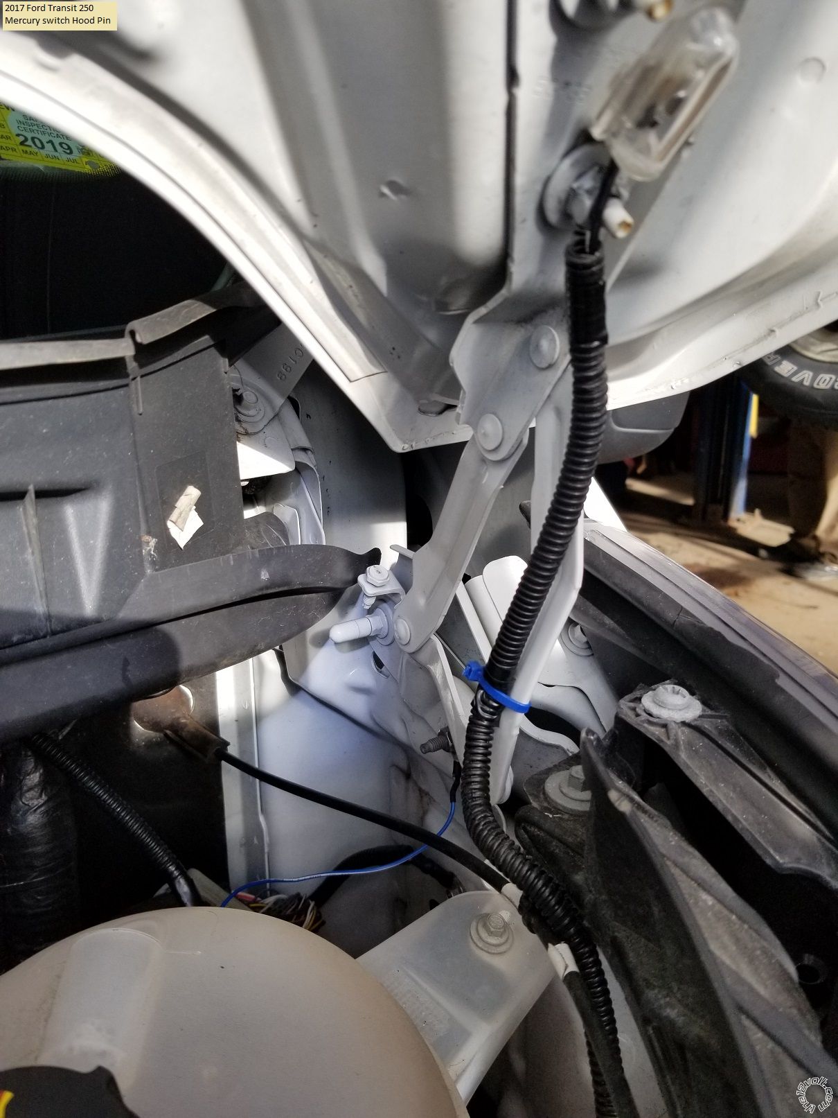

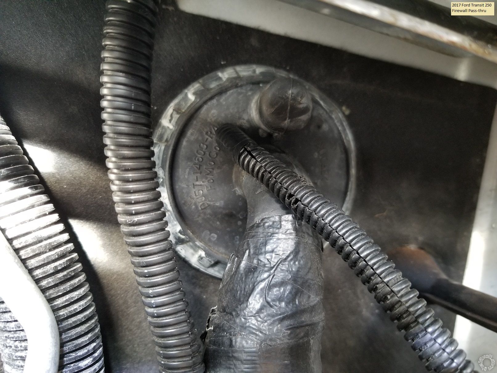

For the Hood Pin wire, there is a large rubber grommet behind the BCM and strut tower for firewall pass-thru as shown in the following photos.
Besides the 4115 R/S system, you will need two 3 Amp diodes. If you choose not to use the 4115 kit supplied hood pin, a Direct 8613 tilt switch is a good, rust-free choice.   Total cost ~ $60.

Do you need a bypass if your van has no PATS option installed? Mine does not.
Platinum - Posts: 7,827
Posted: March 15, 2019 at 8:33 AM / IP Logged Link to Post Post Reply Quote kreg357
If your Transit is like the one pictured about without a PATS antenna ring on the ignition switch you do not need a bypass module. Being as the Factory Remotes work while the engine is running under a remote start-up, a simple one button R/S system is all you need. While I made the R/S to vehicle Unlock wire connection, it is optional.
