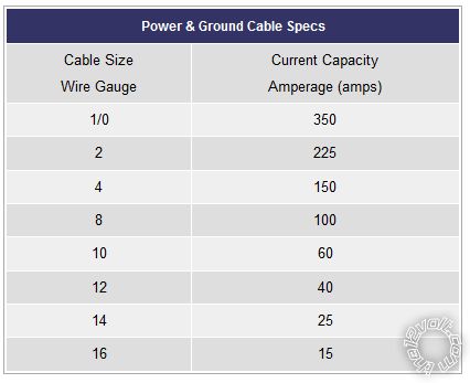

Hi Forum,
Been looking at a few sites to understand wire gauge better for a 4x4 wire loom project. there are a few variations. Most of the 4x4 is rated to 15A @ ~12v. from what i can see 14 gauge suits best...?
to confirm... the Fuse should be rated lower than the wire so in the case of a short the fuse breaks. Also, the fuse should be placed as close to 'supply(+)as possible?

i am looking for generic wiring - not audio only
the12volt
Administrator - Posts: 3,957
Joined: March 07, 2002
Posted: February 06, 2019 at 11:06 AM / IP Logged Link to Post Post Reply Quote the12volt
That applies to generic wiring, not just audio.
Best Guide for Wire 12V Automotive Wire Gauge Guide -- posted image. the12volt • Support the12volt.com
