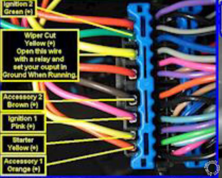

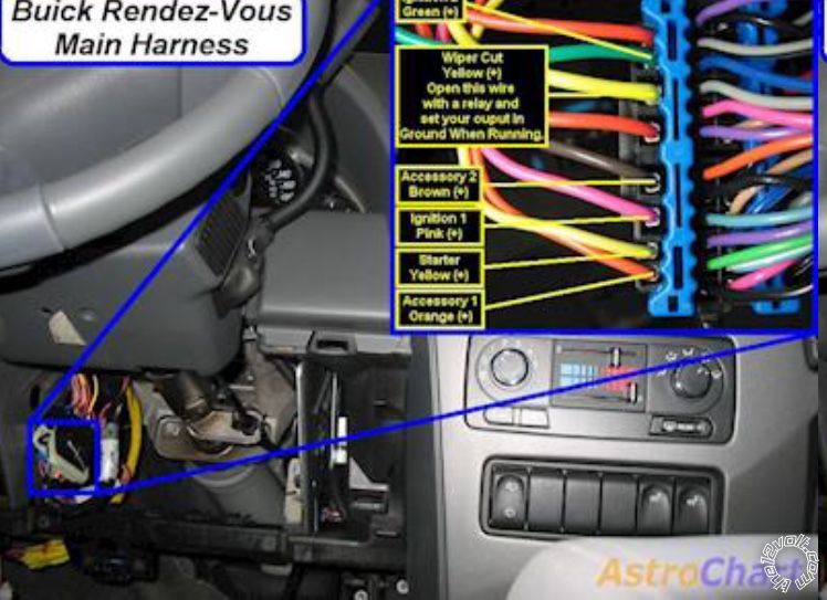

I am installing a Compustar CS800s with a Fortin INT-SL+ in my '06 Rendezvous.
All of the info I can find online just says that the pink ignition wire from the Fortin unit should go to the pink ignition wire in the ignition harness of the car. The issue is, I do not know which pink wire to use. I see 3 pink wires in the ignition harness. Does anyone know what pin the wire is on the ignition harness connector? Or an other way to identify it? Is there a way for me to test the voltage at different key positions to determine which one is the right one? Thank you for any help.

Posted: March 18, 2019 at 1:59 PM / IP Logged Link to Post Post Reply Quote geepherder
I can't tell for sure if only one will test ignition. They might be connected in parallel. Your Fortin install manual should say what connections are required.

2006 Buick Rendezvous Remote Starter Ignition Wire Clarification -- posted image.

Posted: March 18, 2019 at 5:27 PM / IP Logged Link to Post Post Reply Quote iskidoo
dustint91 wrote:
Do I need this on my car? If so, where does it connect and do I need to move the jumper?
Yes leave jumper set to ignition 2 and connect it to the green wire shown in photo in my previous post.

Posted: March 19, 2019 at 12:55 PM / IP Logged Link to Post Post Reply Quote dustint91
Wow nice pictures! I could have used that a few days ago haha. I ended up getting it sorted out last night before seeing this. Took lots of digging online and reading a billion posts. Though seeing these pictures does give me some reassurance that I got the right wires since I did it just as your pictures show. Thank you!
