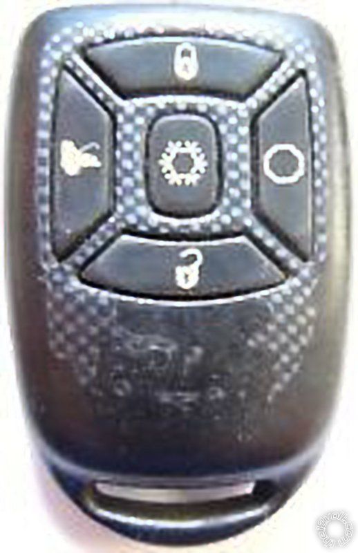

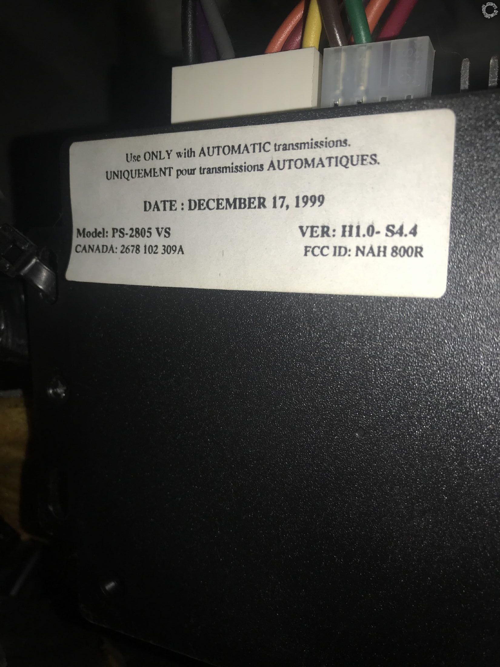

I’m going to try to add pictures of the module & remote I have. PolarStart Remote Start Not Working -- posted image.

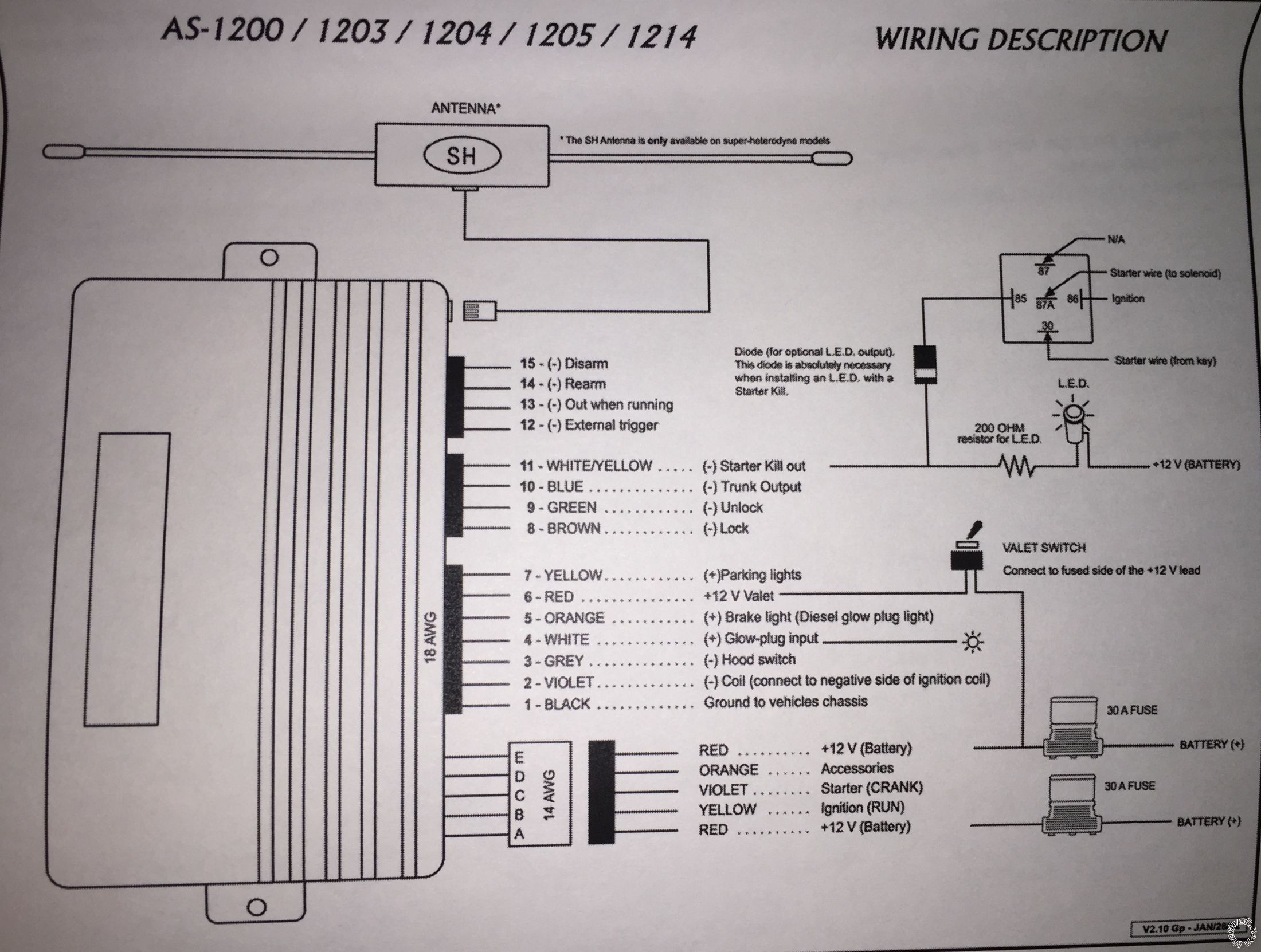

That’s what I was thinking. But now I need to figure out what wires are for the hood pin.
Any thoughts on that? Is there common colors for these or can anyone suggest where to find a wiring diagram.

Posted: July 16, 2019 at 8:42 AM / IP Logged Link to Post Post Reply Quote iskidoo
I think it will be gray.
