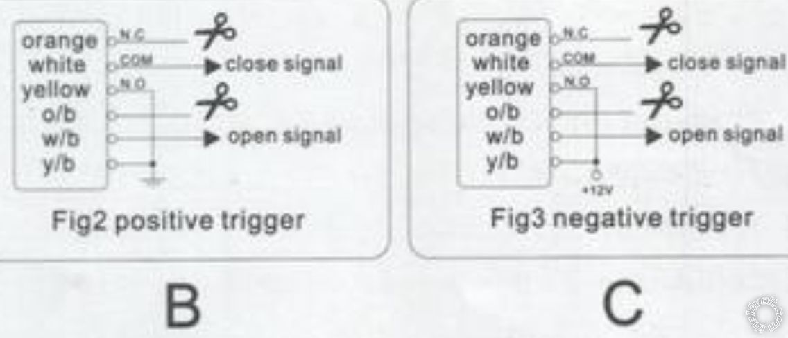

You need to determine if you have type B or type C locks by testing at the drivers switch or in the door jam. Check note #2 on the bulldog wiring diagram and also there are photos at the bottom for reference on both types.
http://diagrams.marktoonen.nl/printlist.aspx?MakeID=18&ModelID=19203
Once you test and figure out the type you can wire it as shown in the diagram from the keyless system. Close signal means lock and open signal means unlock. Both yellow and yellow/black wires will either be going to constant +12v or to ground depending on which type system you determine that you have.
2003 Ford F-250 Door Lock/Unlock Unit -- posted image.

might also be 5 wire locks if it didnt come with a key fob originally. Negative locks if it did and the GEM module will fall asleep after 10 minutes of the truck setting, to test roll the drivers window down lock the door with the door open from the factory button on the door and shut the door, wait 10-15 minutes reach in and try unlock. If it doesn't unlock the GEM module has to be woken up before any keyless entry will work
