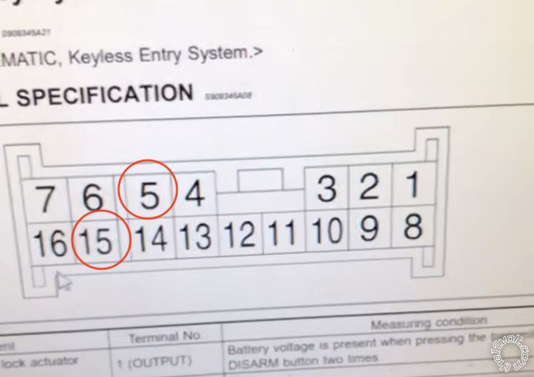

Under power locks, it shows lock as Y (yellow) pin 5 at the keyless entry contol module (under left side of dash). Unlock is listed as LG (probably light green- if not light grey) at pin 15 of the keyless entry control module.

This is exactly what I did. Luckily I have access to Identifix vehicle repair software which had listed power lock as pin 5 (yellow) and power unlock as pin 15 (light green). This info was accurate and and these wires worked perfect. I should note that the unlock wire in my case was light green/blue.
Here's an image of the connector and applicable pins.
