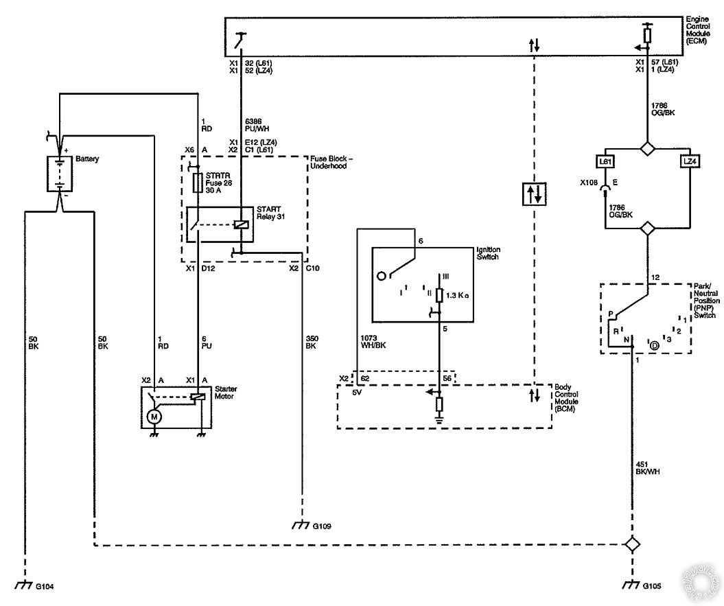

I’m trying to put a starter kill relay on a 2008 Malibu. There’s no starter wire at the ignition cylinder. Any suggestions? Thanks!

If you want to interrupt the starter wire, you need to go under the hood.
I'd probably interrupt the low current control wire (purple/white) from the PCM to the underhood fuse box:
2008 Chevrolet Malibu Starter Kill Wire? -- posted image.

The pcm is located in the center console?

It's under the hood on the driver's side:
https://www.youtube.com/watch?v=l0aU3LWKnU8
