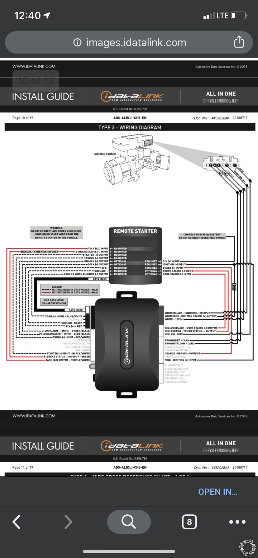

so ended up my remote start was faulty got it replaced. So now I can get it in ready mode and flashes three for ready. I hit my remote to turn vehicle off it then flashes twice for ready confirm and turns off then when I go to remote start it flashes once. Everything inside turns on though then off.. getting close just not sure what else damn. 2008 Jeep Wrangler
Using a ads-alca. The instructions say only two way for expresskit so I need to change option to ads one way, could this be the cause? Left it in expresskit two way as default and everything works but starting
Hey guys I have a basic unlimited x no power features. I picked up a CT-4211TW remote start pro start and a idatalink al-ca.
I wired everything up and the bypass is blinking green. This is a manual Jeep. What I cannot do is get into the programming options of the remote start using the brake pedal which is hooked up to the remote start and not the bypass. Since it’s idatalink ads it’s only one way communication. I program the remote perfectly . But my brake pedal is not recognized and I cannot do much more. I tested at the connector it receives 12v when pressed only. Any ideas? The other that’s connected to the remote start is the tech and e brake. Besides that everything is connected to the bypass. As it instructed
Remote start https://www.prostartsystems.com/Docs/CT-4211TW-4311TW_ig_en_h70s62_VM20150821a.pdf
Bypass in picture2008 Jeep Wrangler Unlimited, CT-4211TW Remote Start -- posted image.

How did you do the clutch bypass? Data bypass does not do your clutch bypass.
