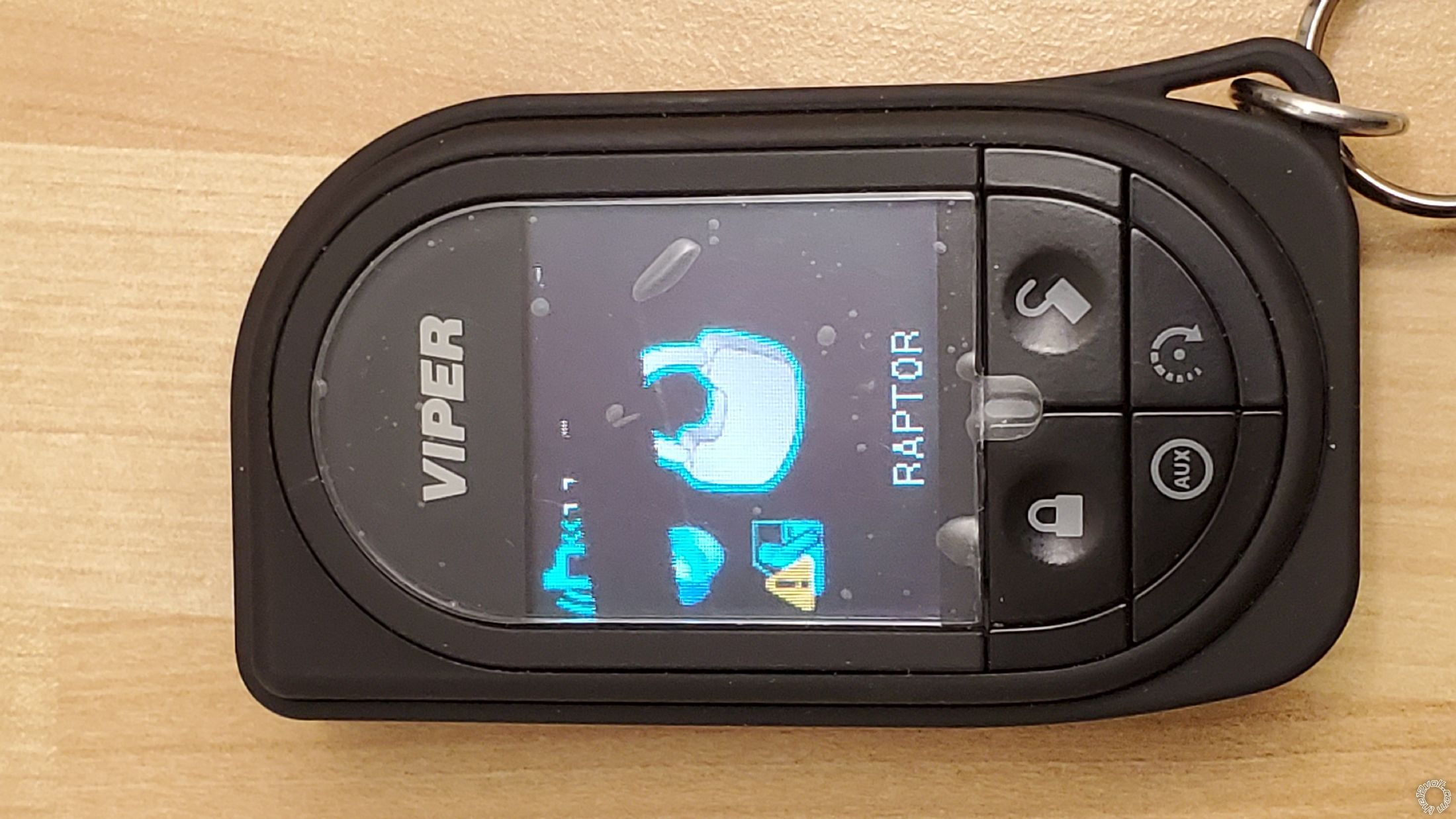

I have a Viper 5906V connected to multiple sensors.
Vehicle: 2019 Ford F-150 Raptor. Push to Start w/factory alarm & remote start
To save a few mA of power when the system is disarmed I have wired all of the sensors to the orange GWA (Ground When Armed) output. Most of the sensors work just fine in this configuration. The sensors are:
504D Shock Sensor
507M Tilt Sensor
508D Field Disturbance Sensor
506T Audio Sensor
Alpine Shock Sensor (old school, ultra sensitive, was waisting 5 mA in standby mode)
When I arm the system it will trigger the 506T Audio Sensor and the Alpine Shock Sensor for the 1st 2-3 seconds and cause the FOB to report a warning condition that a zone is open upon arming. Obviously pressing Arm a 2nd time resolves the issue.
Does anyone have any ideas if there is a way to bypass or ignore a trigger condition for a few seconds after arming, maybe via a setting?
Otherwise I may need to use a time delay relay or something to interrupt the trigger condition briefly. I already have a relay inline to interrup the Shock Sensor during a window down condition to prevent rolling down windows from triggering the alarm while it is armed.
Thanks!

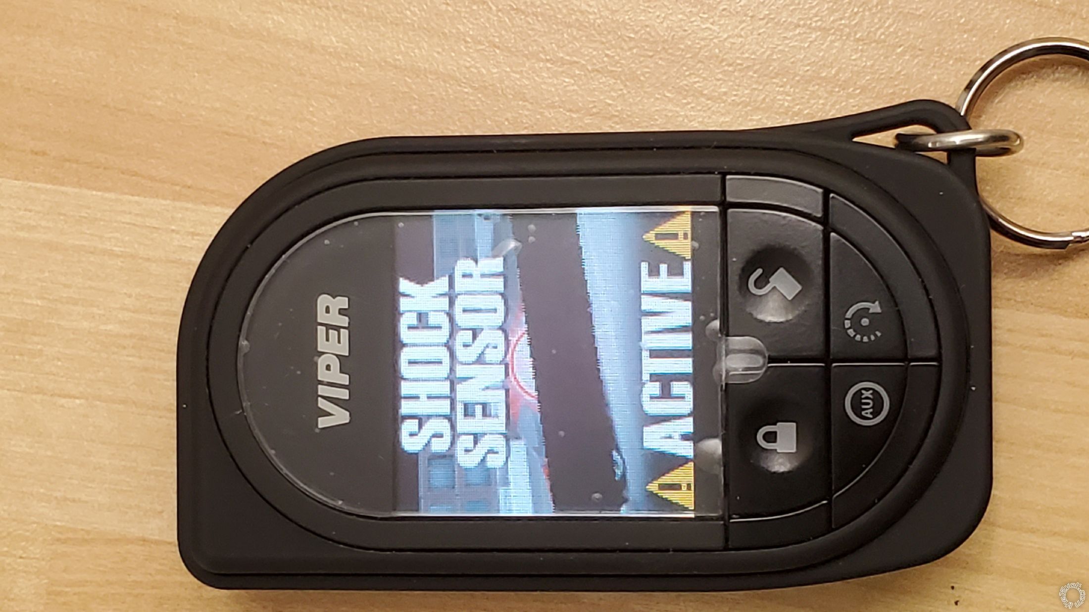

Thanks for the reply geepherder.
But I am not following your response. Menu 2, Options 9 & 10 and the bitwriter Options 4 & 5 all deal with the AUX 1 Output.
I am looking to prevent the Audio and Shock Sensor from trigger a warning while Arming the system, (see images below). So I am not seeing how the AUX 1 Outputs relate to the MUX Sensor 1/Sensor 2 ports triggering.
Can you expand on that relationship?

xtinctelise wrote:
...it appears the sensors just trigger during their inital boot up sequence.
That's exactly what is happening. Grounding all the sensors to the GWA output is not recommended, and diode isolating each of the ground wires to the GWA wire will make no difference. Ground all the sensors properly so they are ready to go when you arm the system.
