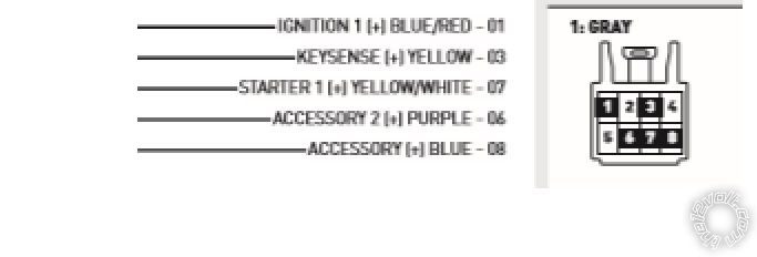

As for the rest of the wires here is a diagram of the main ignition connector :
Avital Remote Start 4115L, 2006 Volvo XC90 -- posted image.
Please note that Pin 3 is Keysense and mandatory. You can power it as IGN2 (+) but will need a relay.

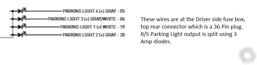

And here is a diagram for the Parking Lights :
You will need four 3 Amp diodes to split the 4115's lone (+) Parking Light output. Make sure the 4115's
Parking Light jumper is set tp (+).

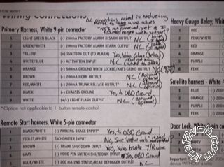

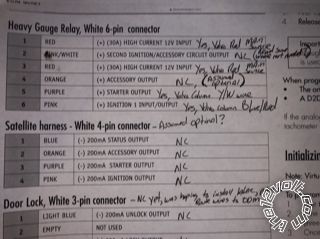

Hopefully these pics will,come thru explaining what I’ve done so far .....but it ain’t working yet.
I read up on the d2d and it sounds like this makes all connections needed except the power and ground? Am I reading too much into that? As you’ll see I assumed many wires could be left out (for now) and that the thing would work as long as I didn’t lock the car and left the key in ignition or near ignition so it reads the chip and would not need an immobile bypassing device...
This is definitely not easy and I’m usually pretty good with stuff like this, or so I thought....but the directions suck. Terrible help from the manufacturer too...

Yep, those pic's are a bit hard to read. Just fill in the below list.
Here is a wire chart for the Viper 4115 :
4115
Primary Harness, 9-pin connector
1 LIGHT GREEN BLACK (-) 200mA FACTORY ALARM DISARM OUTPUT
2 GREEN/WHITE (-) 200mA FACTORY ALARM REARM OUTPUT
3 YELLOW (+) IGNITION OUT (TO ALARM)
4 WHITE/BLUE (-) ACTIVATION INPUT
5 ORANGE (-) 500mA GROUND WHEN LOCKED/ANTI-GRIND OUTPUT
6 BROWN (-) 200mA HORN OUTPUT
7 RED/WHITE (-) 200mA TRUNK RELEASE OUTPUT
8 BLACK GROUND INPUT
9 WHITE (+/-) LIGHT FLASH OUTPUT
Remote Start harness, 5-pin connector
1 BLACK/WHITE (-) NEUTRAL SAFETY SWITCH INPUT
2 VIOLET/WHITE TACHOMETER INPUT
3 BROWN (+) BRAKE SHUTDOWN INPUT
4 GRAY (-) HOOD PIN SWITCH SHUTDOWN INPUT
5 BLUE/WHITE (-) 200 mA 2ND STATUS/REAR DEFOGGER OUTPUT
Heavy Gauge Relay, 6-pin connector
1 PINK OUTPUT TO PRIMARY IGNITION CIRCUIT
2 PURPLE OUTPUT TO STARTER CIRCUIT
3 ORANGE OUTPUT TO ACCESSORY CIRCUIT
4 RED (+) (30A) HIGH CURRENT 12V INPUT
5 PINK/WHITE OUTPUT TO SECOND IGNITION/ACCESSORY CIRCUIT
6 RED (+) (30A) HIGH CURRENT 12V INPUT
Satellite harness - 4-pin connector
1 BLUE (-) 200mA STATUS OUTPUT
2 ORANGE (-) 200mA ACCESSORY OUTPUT
3 PURPLE (-) 200mA STARTER OUTPUT
4 PINK (-) 200mA IGNITION OUTPUT
Door Lock, 3-pin connector
1 LIGHT BLUE (-) UNLOCK OUTPUT
2 EMPTY NOT USED
3 GREEN (-) LOCK OUTPUT
