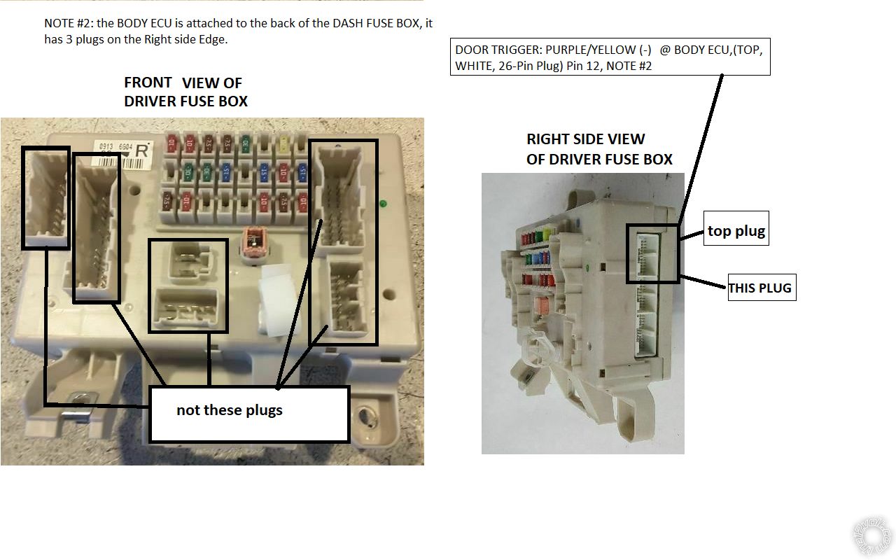

2007 Toyota 4Runner, Compustar CS7502AS, Alarm Only - Page 6 -- posted image.

Ok thats reading 11.6 volts when door opens. Only one wire left!

Excellent! but before we proceed to the next wire. did you test all four doors as i suggested previously? Also, i want to make sure you have placed the "jumper" in the negative position for the polarity of the "door trigger wire" in the alarm module as i suggested before?
the next wire would be the parking light wire and it is in the same plug as the door trigger wire.
test the parking light wire in your truck. set your multimeter to DC voltage. connect the positive probe of your multimeter to constant 12 volt in your truck. connect the negative probe of the multimeter to the parking light wire "green". turn on your parking lights, the multimeter should show 12 volt. turn off the parking lights and the multimeter should show 0 volts. you found the correct parking light wire if your multimeter shows these results.
