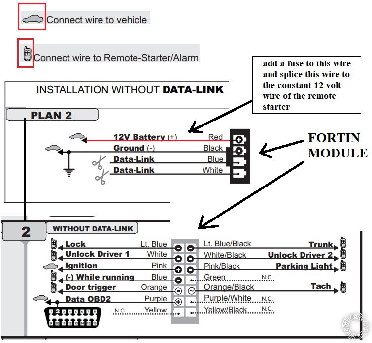

I am attempting to install a SCYTEK A15 Alarm/Remote Start to my 2006 CHEVY TRAILBLAZER.
I am using a FORTIN INT-SL+ MODULE.
Can anyone help me with w2w connection between my alarm and bypass.
I have no idea what connections to make.

Fortin INT-SL+ installation manual: https://cdn02.fortin.ca/download/46281/int-sl+_revj.pdf
The suggested w2w connections for your 2006 Chevrolet Trailblazer are indicated on Page 3, Plan 2.
Make sure all suggested wire connections are made between the Fortin module, the remote starter and your vehicle before going into the programming steps of the Fortin module.
2006 Chevrolet Trailblazer, Scytek A15 Alarm/Remote Start -- posted image.

My Alarm has a Data Bus port can I use this to connect data link or should I do installation without?
djdeito
Copper - Posts: 100
Joined: February 19, 2019
Posted: March 09, 2020 at 1:12 PM / IP Logged Link to Post Post Reply Quote djdeito
yes, you can use the aftermarket alarm Data bus port and follow Fortin's "Data-link" wiring diagram on page 3, plan 1, wiring schematic 2. Just make sure to set the "Data Bus Interface Mode" port on your aftermarket alarm to "Fortin"
