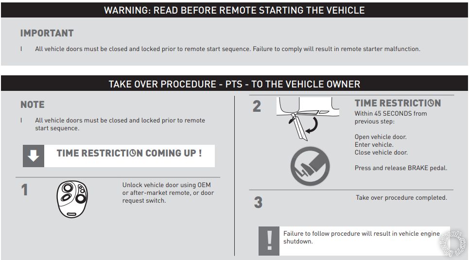

i just want to make sure we didn't overlooked the instructions, did you wire the "connections required for takeover" as suggested in the iDatalink bypass guide?
so you remote start your car, unlock the door, and within 45 seconds you open the driver's door, enter the car and step on the brake pedal,and your car shutsdown when you step on the brake pedal?
Normally, some Push-to-start vehicles shutdown upon opening the driver's door.
in the Astra A777, try setting branch #33 "validation/brake input mode" to "brake"
re-test takeover.

adding to my previous post, i left out one step regarding Takeover.
2015 Hyundai Sonata, Security and Remote Start - Page 2 -- posted image.

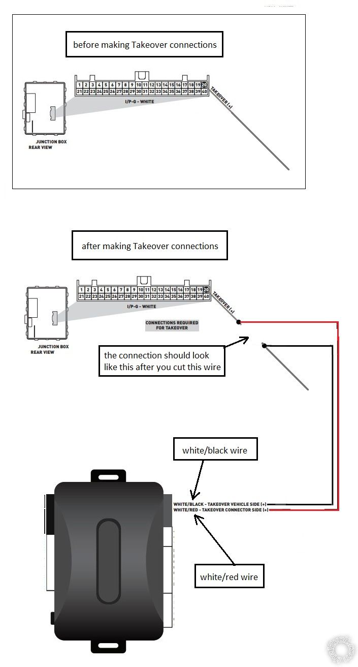

On the previous page the wiring diagram states to connect the two wires then cut one of them ,which one should be cut? Also went through the takeover procedure but it continued to run til time ran out then shut down.

Posted: March 15, 2020 at 10:06 AM / IP Logged Link to Post Post Reply Quote djdeito
Does your Takeover connection look like this:

Posted: March 15, 2020 at 10:50 AM / IP Logged Link to Post Post Reply Quote dhall764
i connected both together and didn't cut the black/white wire as shown on the diagram.
