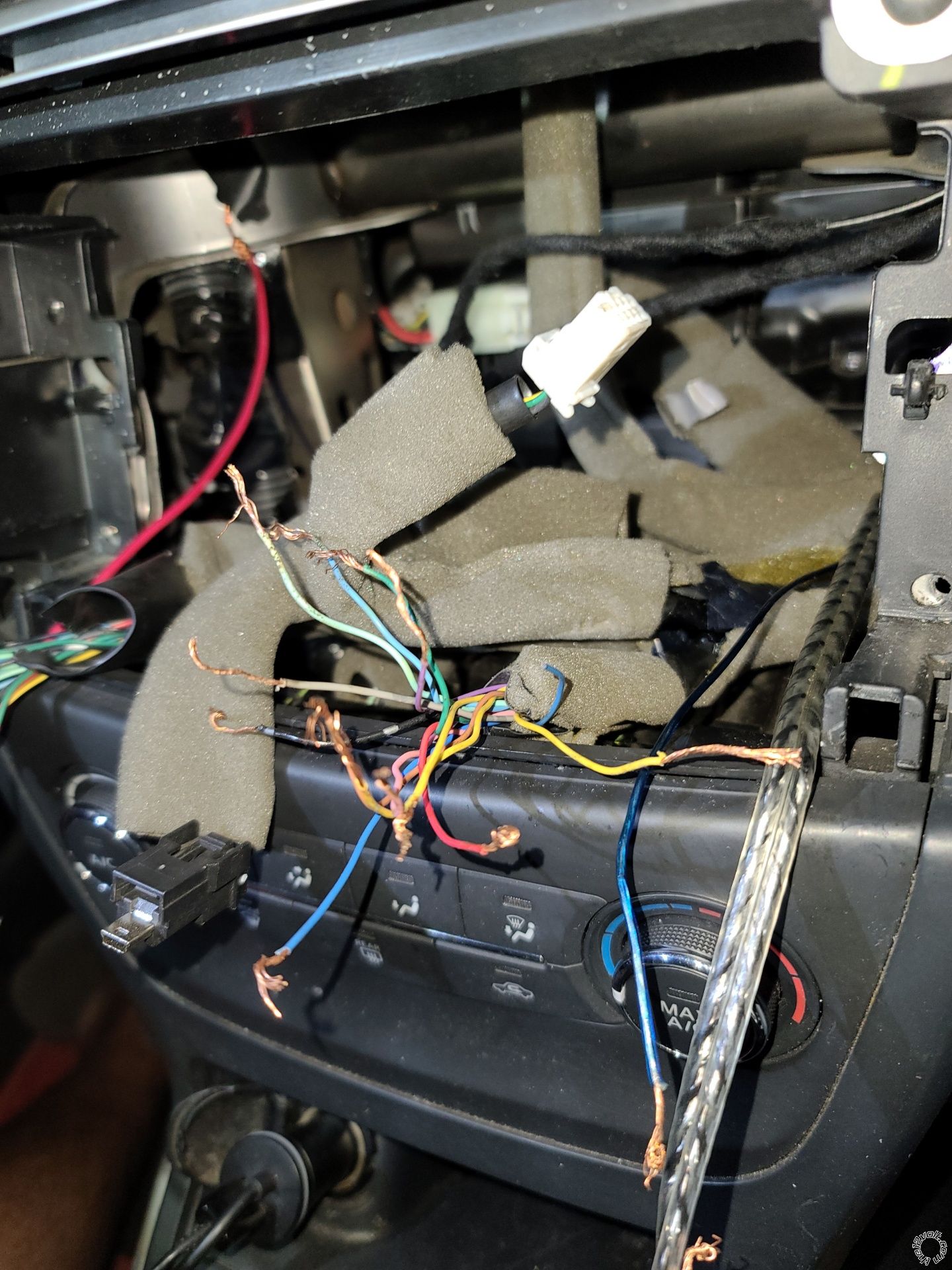

Would anyone happen to have the stereo wiring diagram for a 2016 Nissan sentra? No nav, push button start SV model. Previous owner cut the factory harness. I am trying to install an aftermarket stereo 2016 Nissan Sentra, Stereo Diagram -- posted image.

Should be same as listed above. Did you check to see if you had the same colors?

Posted: May 27, 2020 at 2:08 PM / IP Logged Link to Post Post Reply Quote jnamee
It does but i have an extra yellow,also a black, a violet and a gray unaccounted for. I found the 12v yellow and ground new stereo to chassis but can't seem to get the radio on. Ive tried connecting the switch wire to different colors still nothing. Thanks in advance.
Ps. Previous owner said it used to only turn on when headlights are on. Trying to get everything wired the correct way.
