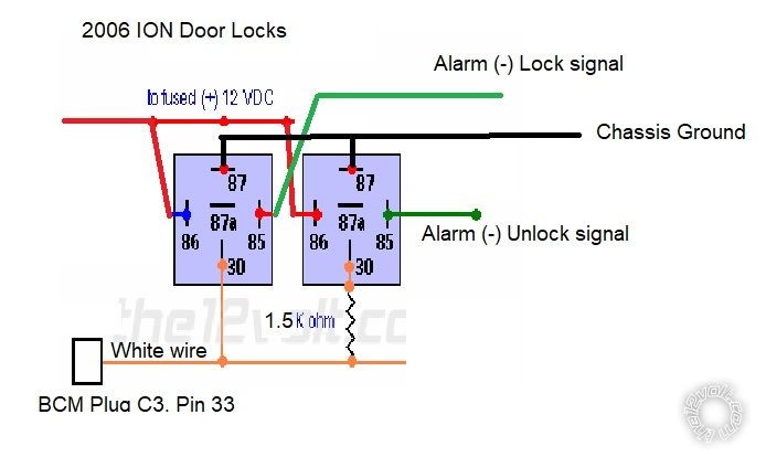

You have it pretty much figured out. You didn't mention which Brand and Model of aftermarket alarm system you are installing but if it outputs the common (-) 200 mA lock signals you will need some relays or a Directed 451M door lock module. The 451M is about $11 and is a nice compact package that comes with an assortment resistors that will include the 1.5K ohm resistor you need. Also, rather than going into the doors and all the headaches that come with that, the Lock wire is found inside the vehicle at the BCM. Here is the lock wire info from Bulldog Security :
POWER LOCK     WHITE (1-Wire System) See NOTE #2     @ BCM C3, PIN 33
POWER UNLOCK     Same wire @ BCM C3, PIN 33
NOTE #2
LOCK IS A STRAIGHT (-) NEGATIVE TRIGGER.
UNLOCK IS A NEGATIVE THRU 1.5K OHM RESISTOR
If you had two SPDT 30/40 Amp relays and a 1.5K resistor plus an inline fuse holder with a 10 Amp fuse, you could wire it up following this diagram :
2006 Saturn Ion, Door Lock/Unlock Wires -- posted image.

I just took another look at the wiring diagram in the owners manual for the alarm and it looks like this could be actually pretty simple to remedy! Since it has separate outputs for lock and unlock, I'm thinking all I have to do is put a 1.5k resistor at the end of the unlock wire from the alarm at the white wire! I can actually run BOTH the wires, lock AND unlock, to that white wire from the switch and just put the resistor on the unlock wire. Since it would only get a signal from one of those two wires at a time, it wouldn't be dangerous or stupid. LOL!

Good info on the Scytek brand. I've never used one but going by their install guide, the lock outputs are not from internal relays. The current G20 model has (-) lock outputs rated at 500 mA. That current rating might be enough to support a direct connection to the White one-wire vehicle lock wire. Some car brands and models need a stronger ground signal, hence the 451M or relays. Too bad about Radio Shack. Makes finding a resistor a bit harder. EBay has them, you could even get an assortment pack. You should be OK with 1/8 or 1/4 watt resistors. As mentioned, the resistor is included with the 451M module.
As for the actual White wire, the BCM is inside the car, part of the fuse box. Makes finding the correct wire easier when yop have the Plug and Pin number. Going into door, with trim removal and the flex harness in the doorjamb can be an issue. Here is the info from Bulldog Security.
THE BCM (Body Control Module) IS PART OF THE FUSE/RELAY BOX IN THE LOWER CENTER OF THE DASH, JUST BELOW THE HVAC CONTROL ASSEMBLY.IT HAS THE FOLLOWING CONNECTORS : C1-37 PIN BLACK PLUG, C2-38 PIN GRAY PLUG, C3-56 PIN BLACK PLUG, C4-56 PIN GRAY PLUG, AND C5-6 PIN GRAY PLUG.

I would suggest as Kreg says to use the 451M and don't run the outputs directly to the white wire to be on the safe side. If you burn out those outputs your going to have to replace the whole brain module to get the lock outputs working again. The 451M would keep those outputs from ever being overdriven with current and the proper resistor is included in the kit. If you do run them direct I would think that diode isolation would be necessary.

Got the 451M ordered and should get it today! Also got a few extra resistors as suggested (ordered before the module). Now the only thing is to find time, and a dry day! Had the alarm since the beginning of the year, and like they say, it's not going to install itself! LOL! I gotta get on this! Too much car audio installed to not have a good alarm with proximity sensor! The factory alarm has done okay so far but I need to upgrade! Just had to get this unlock issue worked out so I don't have to carry around two remotes.
As for connecting the lock/unlock wires from the alarm to the BCM, that seems like a huge pain! It's too hard to identify the correct wires coming out of the BCM, and even harder to get to them. But I'll check it out.
