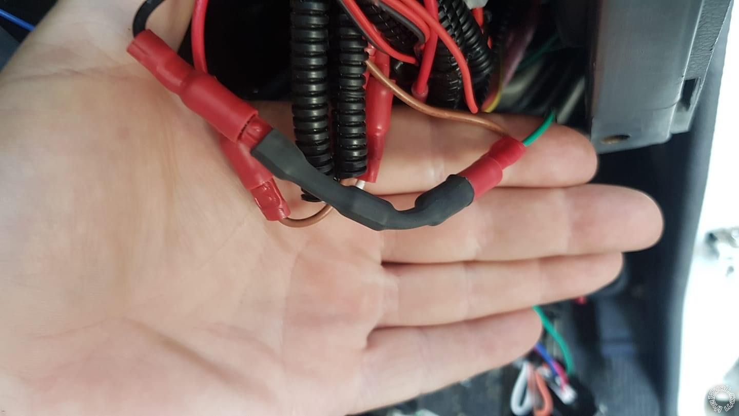

henno
Member - Posts: 9
Joined: July 27, 2020
Posted: October 03, 2020 at 10:42 PM / IP Logged Link to Post Post Reply Quote henno
Thanks mate. I crimped the diode onto bullet terminals an put heatshrink on the whole thing. Works a treat now.
