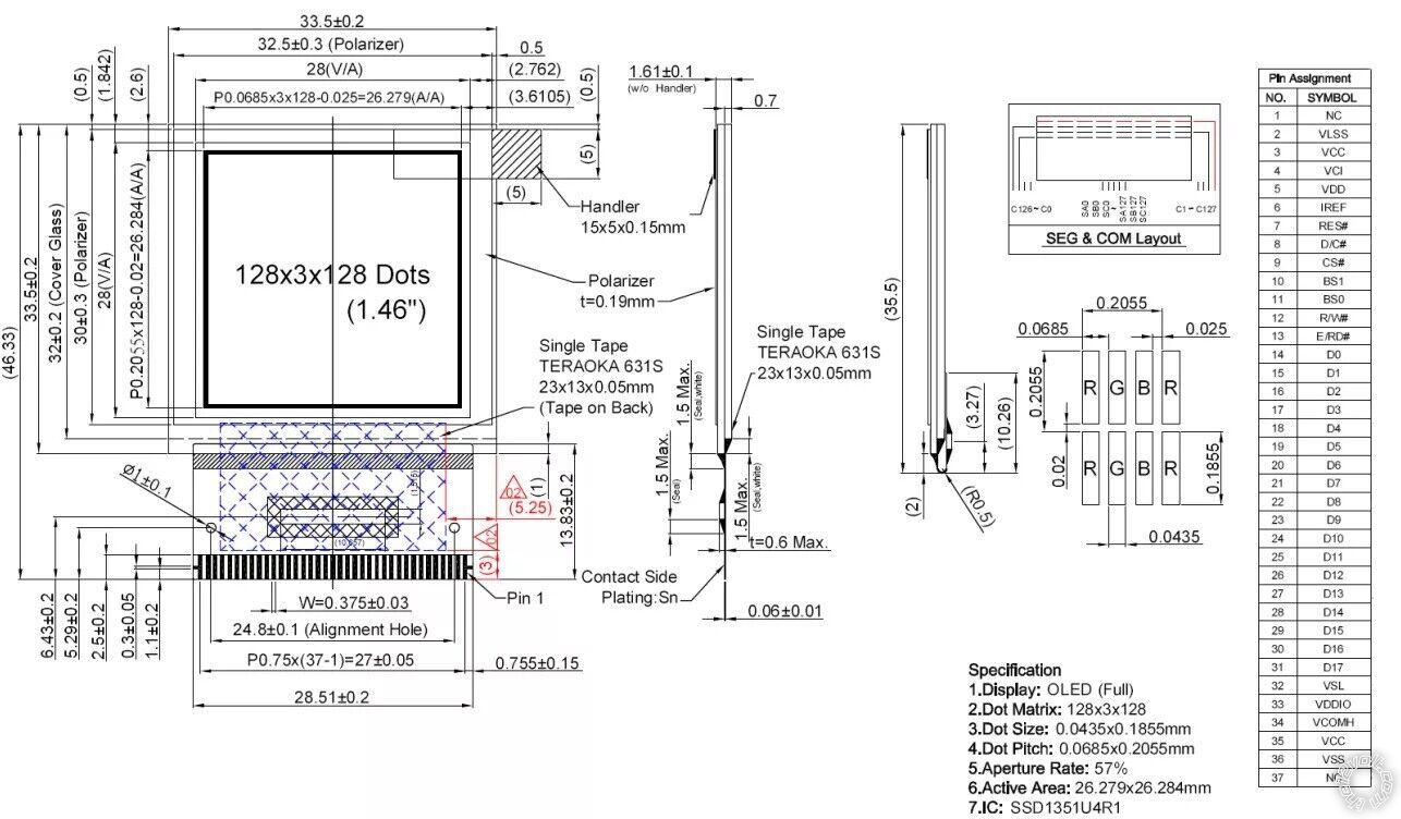

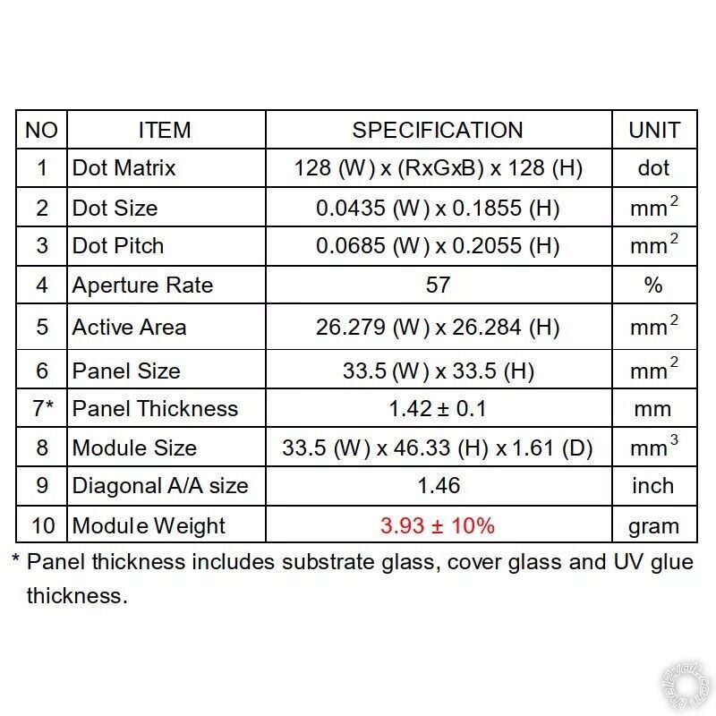

I also found more specs of the screen
Viper 7941v P/X HD OLED Screen Replacement -- posted image. Viper 7941v P/X HD OLED Screen Replacement -- posted image. Viper 7941v P/X HD OLED Screen Replacement -- posted image.
