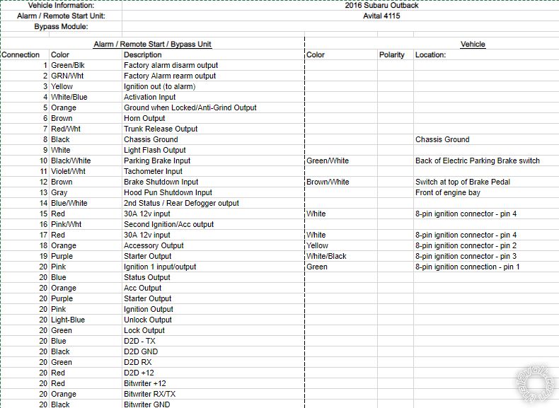

Here are the connections I've made. I don't have the immobilizer bypassed so I have been trying to test it with the key in the ignition. Do you have any other suggestions?

Platinum - Posts: 7,828
Posted: January 31, 2021 at 2:50 PM / IP Logged Link to Post Post Reply Quote kreg357
Here is how the 4115 main ignition harness should look :
Heavy gauge relay wiring diagram
1 RED...................... (+) (30A) HIGH CURRENT 12 INPUT............WHITE (30A)   IGNITION SWITCH WHITE 8 PIN CONN, PIN 4
2 PINK/WHITE...... (+) PROGRAMMABLE OUTPUT FOR ACC OR IGN...............BLUE (+)   IGNITION SWITCH WHITE 8 PIN CONN, PIN 5    set to IGN2
3 RED...................... (+) (30A) HIGH CURRENT 12V INPUT............WHITE (30A)   IGNITION SWITCH WHITE 8 PIN CONN, PIN 4
4 ORANGE............. (+) (30 AMP) OUTPUT TO ACCESSORY CIRCUIT..........YELLOW (+)   IGNITION SWITCH WHITE 8 PIN CONN, PIN 2
5 PURPLE.............. (+) (30 AMP) OUTPUT TO STARTER CIRCUIT............WHITE/BLACK (+)   IGNITION SWITCH WHITE 8 PIN CONN, PIN 3
6 PINK.................... (+) (30 AMP) OUTPUT TO IGNITION CIRCUIT.......GREEN (+)   IGNITION SWITCH WHITE 8 PIN CONN, PIN 1
You will need an external 30/40 Amp SPDT relay for the required Starter2 wire. Here is that wiring :
Relay for Starter2 circuit
Relay Pin 85 to 4115 ORANGE (-) Starter Output
Relay Pins 86 and 87 to WHITE (30A)   IGNITION SWITCH WHITE 8 PIN CONN, PIN 4 through 20 Amp fuse
Relay Pin 30 to GREEN/RED (+)   IGNITION SWITCH WHITE 8 PIN CONN, PIN 7
Relay Pin 87a not used - insulate
If your Outback has an automatic transmission and the engine won't start unless the transmission selector is in Park or Neutral, you can connect the 4115 Black/White Neutral Safety wire to Chassis Ground.
