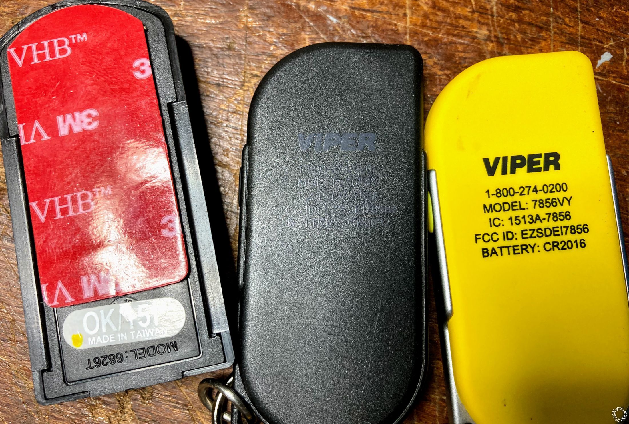

Have you tried both remotes? Verify the FCC ID numbers match on the back of the remotes as well as the antenna.

check continuity through the antenna lead (all ok - my first step)
