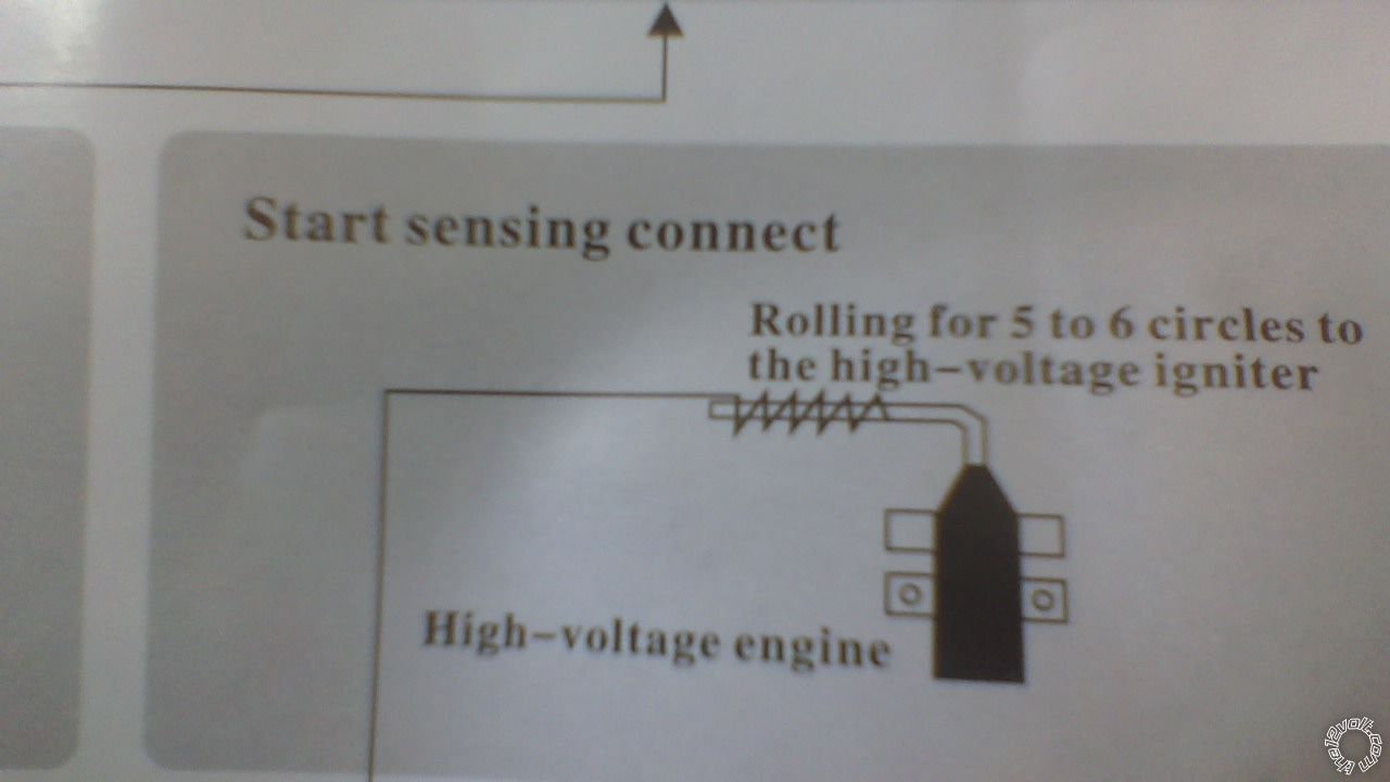

Also, I need some help with a few other issues I'm not understanding with the instructions that were sent with the system. The first is the system diagram shows a start sensing connection that I need to make. It looks like I need to wrap a wire around the high voltage igniter with the picture showing what appears to be a wire going to a coil. I'm unsure what I'm supposed to connect to. Can I just tap into the igniter circuit wire?
2015 Toyota Tacoma, Stellar STRS9960 Alarm/Remote Start -- posted image.

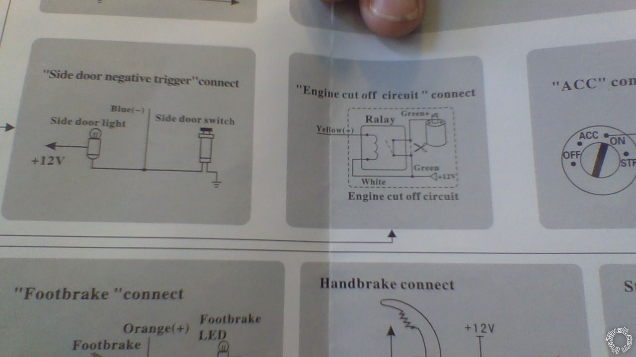

Another question I have is about the engine cut off circuit. I'm not sure which relay the connection is supposed to be made to and how the connection is supposed to be made.
