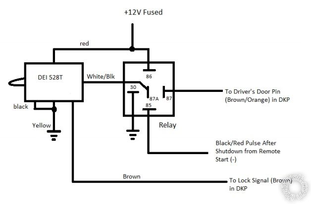

Just reading through the forum again, I found the information psoted by lectricguy.
Looks like this should fix both issues I am having, but I just have one question, can I tie the wires from the Timer, Brown and from the Relay Brown/Orange at the same connection points I already made from the remote start Lock and driver door pin, no doides or anything required?
2012 Hyundai Accent, Prestige APS-687TWE -- posted image.
Thank you.

Looks like you've got the proper wire outputs figured out.
Use 16 Black w/ Red trace Wire: to DOOR TRIGGER     BROWN/ORANGE (-) WHITE 39-PIN PLUG, PIN 39 @ DRIVERS KICK PANEL
This will simulate the door opening after shutdown which should turn the headlights off.
Use 14 Black w/ Light Green trace Wire: to POWER LOCK     BROWN (-) WHITE 39-PIN PLUG, PIN 15 @ DRIVERS KICK PANEL
This should pulse the locks closed after the remote start gets going.
You don't need that timer/relay circuit for anything.
