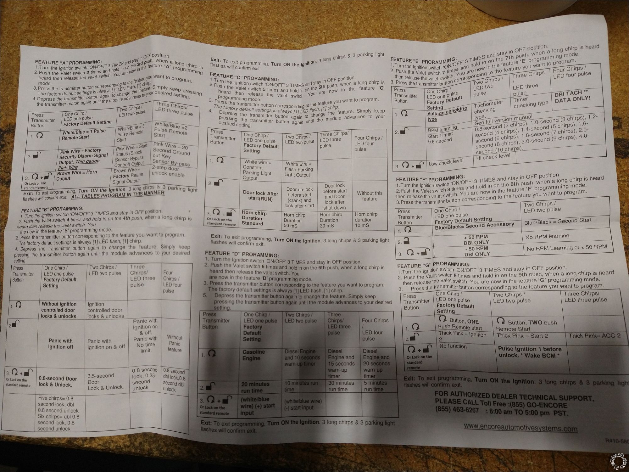

I am at my whit's end.
I have an Encore E5 installed on a 2015 Rogue Select W/O Intellikey. The vehicle will crank (now - after several "programming" attempts), but will not start.
I added an OmegaLink OL-MDB-ALL which I flashed with the provided program. After installing the Omegalink, they informed me that the module was working properly and that my problem was with the Encore unit.
Encore doesn't exist anymore (from what I can tell) and Sonic Electronics isn't replying to my emails.
On the back of the installation guide (which I've attached) it has several programming features. I've completed A, D, and E. I have E set to Voltage Checking Type - Hi Check Level. 2015 Nissan Rogue Select, Encore E5 Installation -- posted image.
This turd still won't start, but cranks enough that it SHOULD start.
There are ZERO problems starting the car with the key otherwise.
Any assistance would be greatly appreciated.

When you try to remote start, does the immobilizer light stay on? If so, without turning your key, just place it in the ignition and try again. If it remote starts, the problem is bypass related. It doesn't necessarily mean that the bypass doesn't work- it could be that it's not getting a signal from the remote start.

are you sure the pink ignition wires are correct? Pink at pin 1 is ignition, (next to the t h i c c red) the other pink is accessory... like the other poster has said, stick the key in the ignition, and try remote starting it. if it runs, it's the bypass.. also check the immo cut, you are feeding immo the bcm, not the transponder module.
