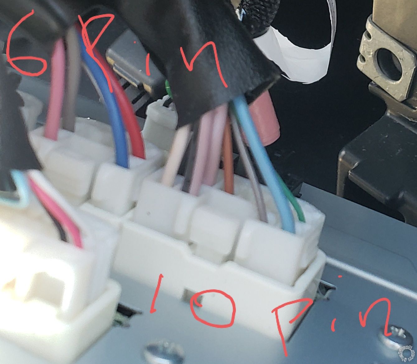

Radio 12V     Lt. Blue or Lavender/Lt. Blue     +     Radio, white 10 pin plug, pin 4
Radio Ground     Brown     -     Radio, white 10 pin plug, pin 7
Radio Ignition     Gray     +     Radio, white 10 pin plug, pin 3
Radio Illumination     Green (parking lights); White (dimmer)     +,-     Radio, white 10 pin plug, pin 10 (parking lights); white 6 pin plug, pin 5 (dimmer)
Left Front Speaker (+/-)     Lavender/Black - Lavender/Gray or Brown - Lt. Blue     +,-     Radio, white 10 pin plug, pins 2 - 6
Right Front Speaker (+/-)     Lt. Green - Blue or White - Black or Lt. Green - Pink     +,-     Radio, white 10 pin plug, pins 1 - 5
Left Rear Speaker (+/-)     Blue - Red or Green - Red     +,-     Radio, white 6 pin plug, pins 2 - 6
Right Rear Speaker (+/-)     Pink - Gray     +,-     Radio, white 6 pin plug, pins 1 - 3

2019 Toyota Highlander, Non-JBL Speaker Wire Colors -- posted image.
right on the money. hard to find info no this vehicle so thank you so much.
