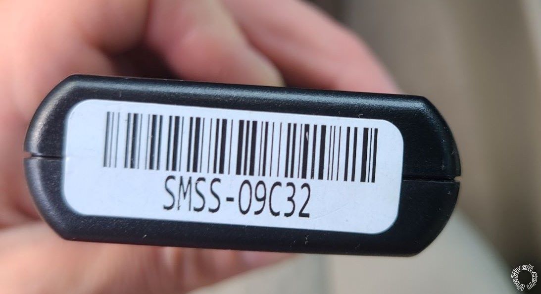

Directed Activation -- posted image.
In your opinion guys what symbols represent that photo? Is it SMSS-09C32 or SMSS-O9C32 Is it zero or O? The guy who activated put O and guy from other store said its 0 in my opinion it's also 0 (zero).

just looked it up and its activated- this is the second numbers you listed first ones don't exist
Air ID: SMSS-O9C32
Installation Date: 5/26/2021
System type: Digital/D2D (02)
RSSI: -63 dB
Number of satellites: 8
that's all the info it gives me, no personal info or anything just that its activated and it has reception

Ok. Good thanks for that info mgoetz74.
It's looks like module is bad. There's no more explanation for that.
