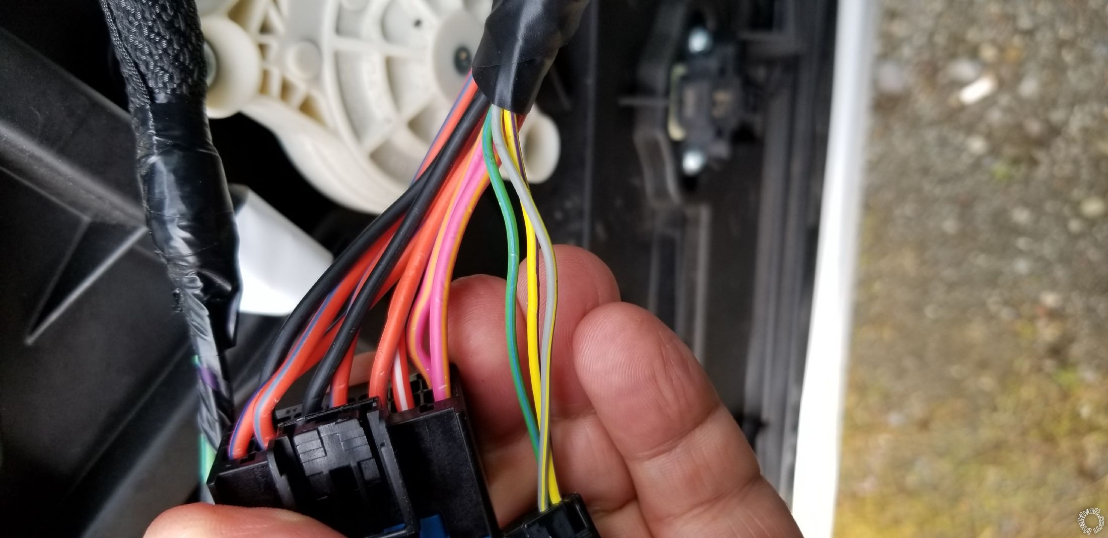

Posted: June 11, 2021 at 9:27 AM / IP Logged Link to Post Post Reply Quote alfwc55
I could not find the wire you mentioned so I took a photo of the wires in the door that are similar to what you described. 2015 Ram 1500, Master Switch Door Lock Issue -- posted image.

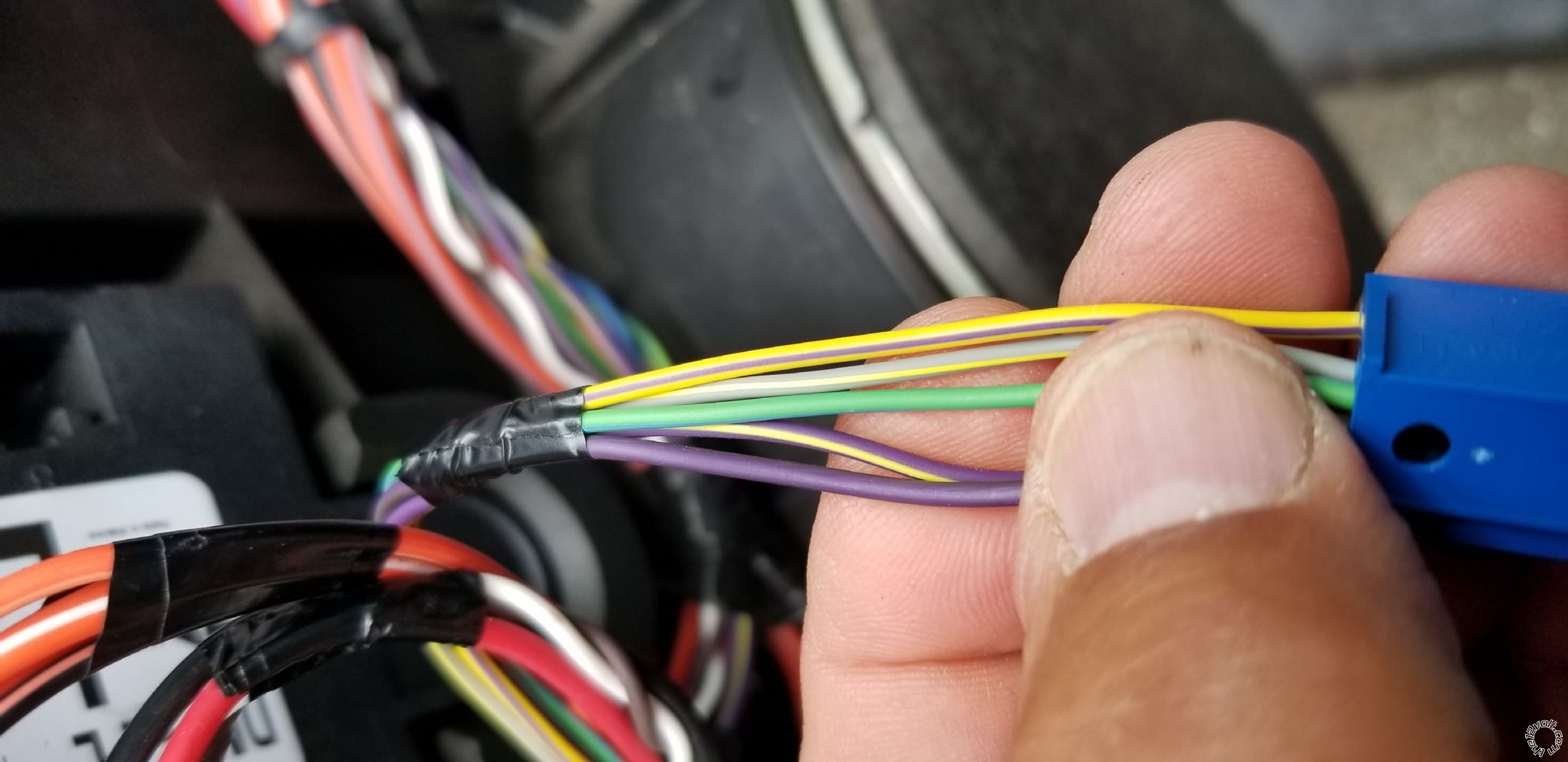

Posted: June 11, 2021 at 9:34 AM / IP Logged Link to Post Post Reply Quote alfwc55
Attached is a photo of the wires going directly to the switch. 2015 Ram 1500, Master Switch Door Lock Issue -- posted image.
