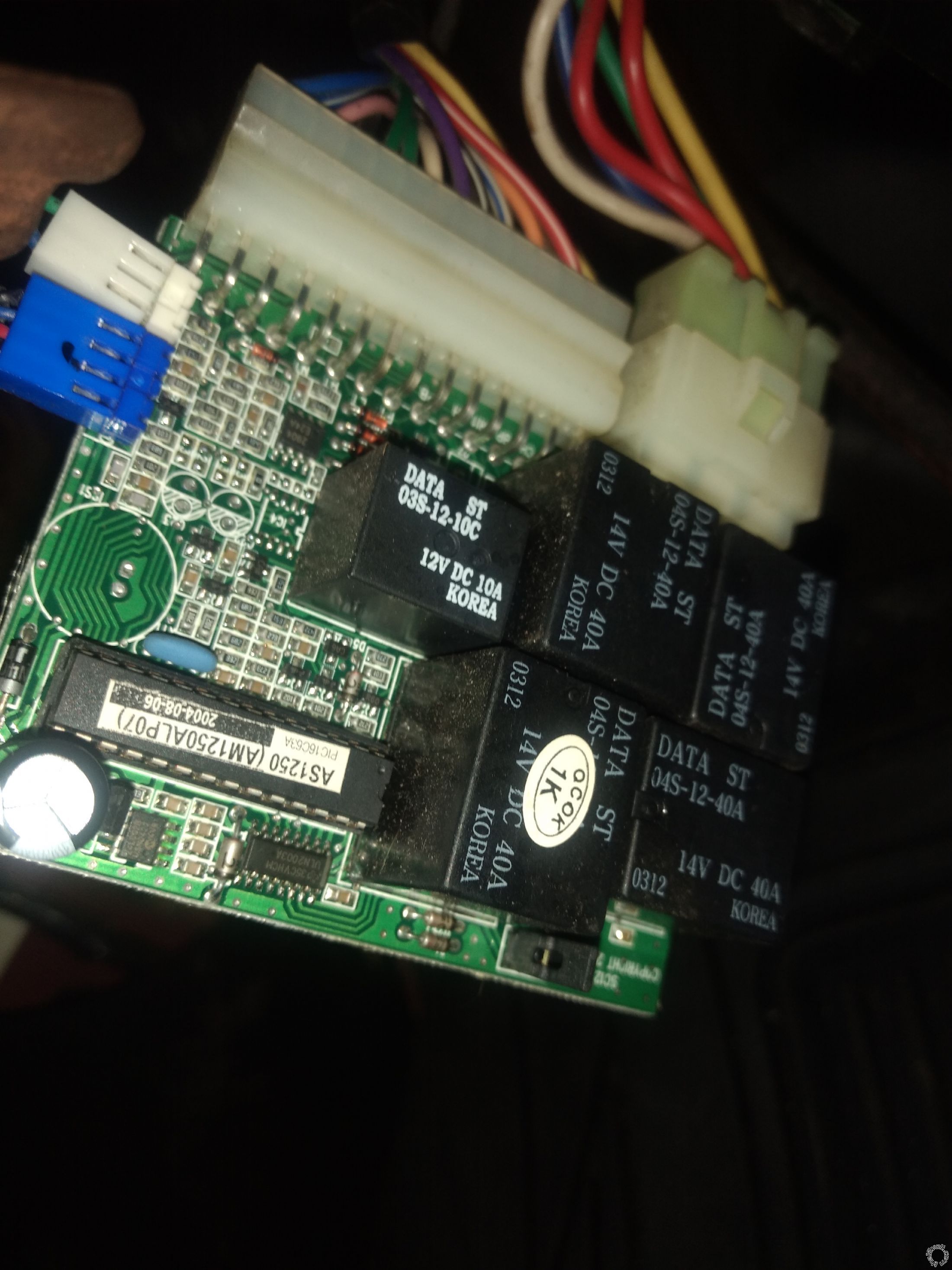

So I wanted to let you know that I finally heard back from ultrastart, I explained what was going on they had me check a couple things and diagnosed it as a bad output goin to the lights, said I could send it in to have it repaired going to call Monday and see how much they want if it's too much I'll prob just keep it as it is. Thanks again for your help Semper Fi

Hello been having problems with my headlights not turning on when I autostart/ unlock/lock doors ended up being a bad connection coming from the light output of the brain and my brown headlight wire whoever installed them didn't even put any electrical tape on it, anyhow I followed the white wire down to the harness and there is a small brown mark on the harness but while I was at it I took the brain apart to see if it had any damage to the board luckily there was none, while double testing the wire while pressing lock unlock nothing was happening but the clicking was still going on, I decided to put my tester on what reminds me of a two legged staple directly under the white wire on the board and to my surprise while clicking the remote it was flashing lights and clicking, so anyway I can fix this? Would it be safe to pull the white wire from the harness strip it some and attach it to the 'staple" on the board? Ultra Start UT1150 Lights Not Flashing, 2004 Ford F-150 - Page 2 -- posted image. i posted a pic so you can kinda see a basic idea of what I'm talking about thanks
