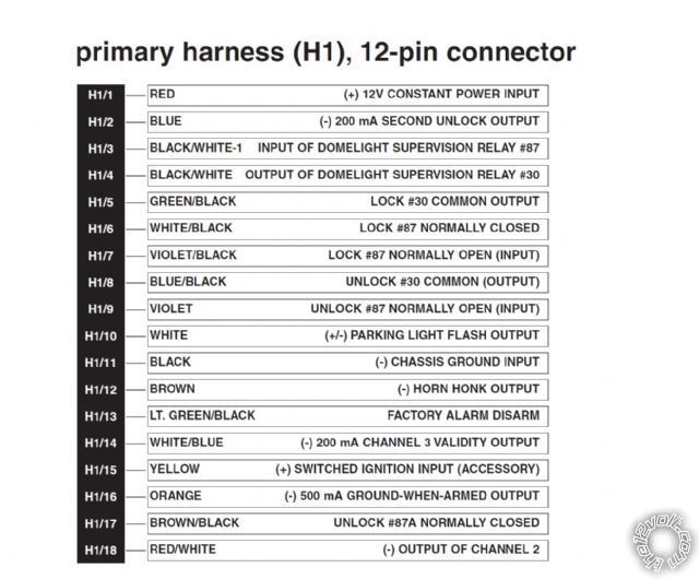

I wired the 2101L like this... H1 (red) to 12+. H5 (GN/BLK) to the lock trigger wire from the GEM to the lock relay. H8 (BL/BLK) to the unlock GEM trigger wire. H7 (P) and H9 (P/BLK) to ground. H11 (BLK) to ground.
My understanding is the relays in the 2101L work like a Bosch 5 pin. H7 and H9 are your source inputs (circuit 87, going to ground since I want the relays to output neg). H5 and H8 are your outputs (circuit 30). Circuits 85 and 85 are internal to the unit. 87A should be not used.

Try this way using the lock wires in the drivers kick panel :
Lock
H1/5 Green/Black Pin 30 PINK/YELLOW IN DRIVERS KICK PANEL
H1/6 White/Black Pin 87a not used
H1/7 Violet/Black Pin 87 Chassis Ground
Unlock
H1/8 Blue/Black Pin 30 PINK/LIGHT GREEN IN DRIVERS KICK PANEL
H1/9 Violet Pin 87 Chassis Ground
H1/17 Brown/Black Pin 87a not used

Kreg357, this is how I currently have it wired. The two wires I have it tapped into on the car are the PK/Y and the PK/LG, which are the trigger wires from the GEM to the lock/unlock relays. These wires also go to the door switches.
