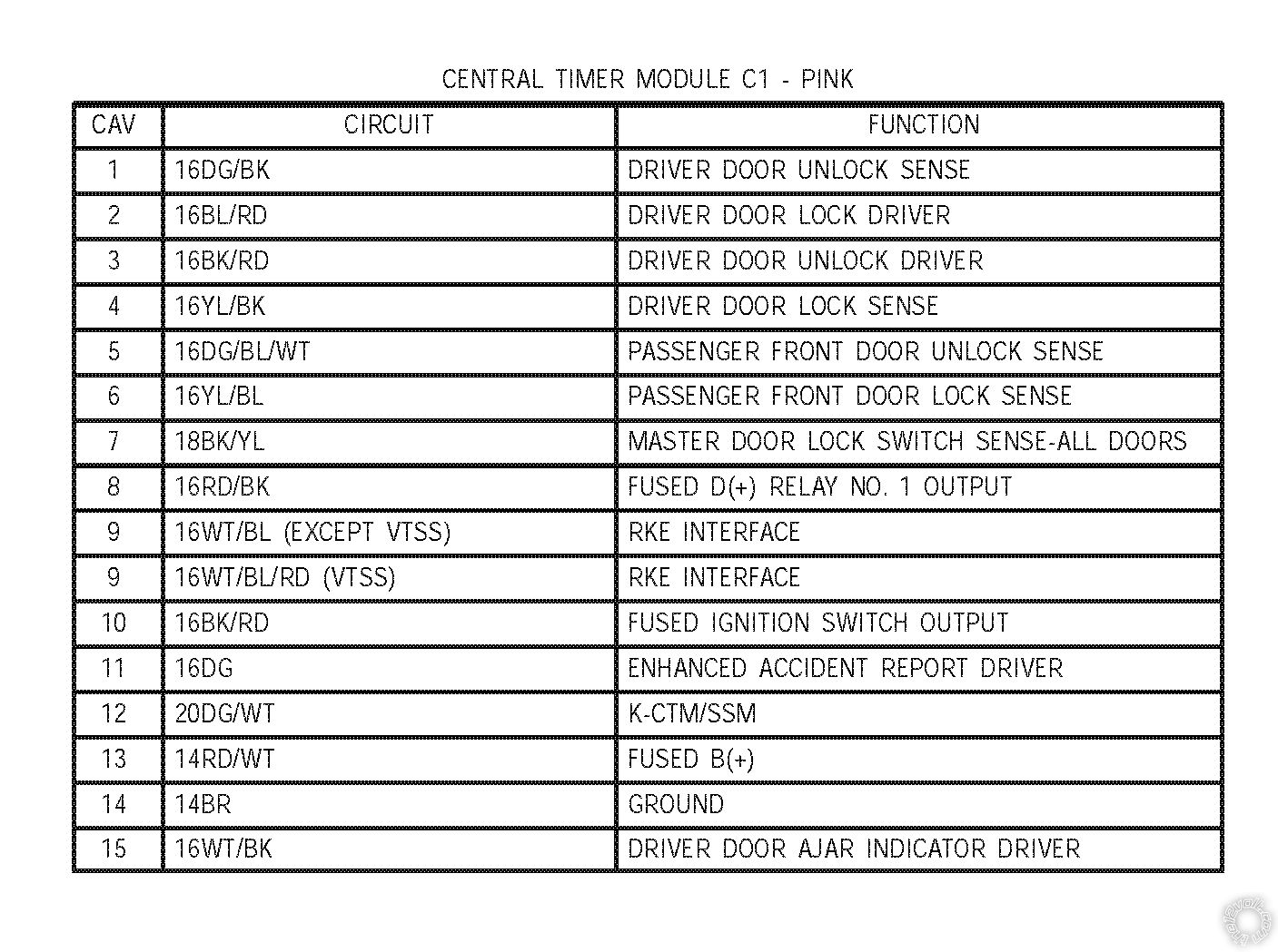

So I am wiring the door locks...I don't have a door relay? My door locks are controlled by the CTM.
Do I need the 451m Door Look Relay?
This is from the sprinter wiring manual.
Starter Kill Relay on Viper 5806v -- posted image.
I would like to unlock all doors.
Thanks for the help.
2005 Mercedes Sprinter

"So I am wiring the door locks...I don't have a door relay? My door locks are controlled by the CTM.
The simple / easy way to handle the door locks is by using one wire that causes the locks to lock with a pulse and then unlock with the next pulse, alternating back and forth.
Lock............WHITE/YELLOW..................AT SWITCH ON DASH OR CTM PINK PLUG, PIN 7......NEGATIVE PULSE ALTERNATES
Unlock..........WHITE/YELLOW..................same wire
If you want to ensure a FOB Lock press/command locks the Sprinter, and a FOB Unlock press/command unlocks the vehicle, then buy three 30/40 Amp SPDT relays with 5 wire harnesses and follow DEI Teck Tip 1700, link below :
https://www.the12volt.com/installbay/file.asp?ID=490
