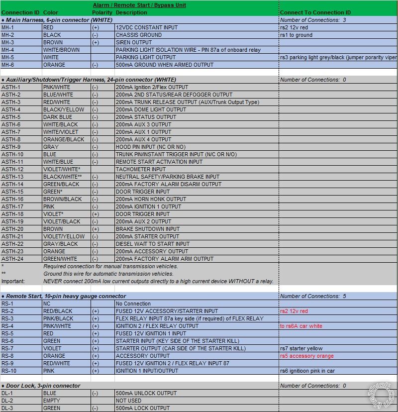

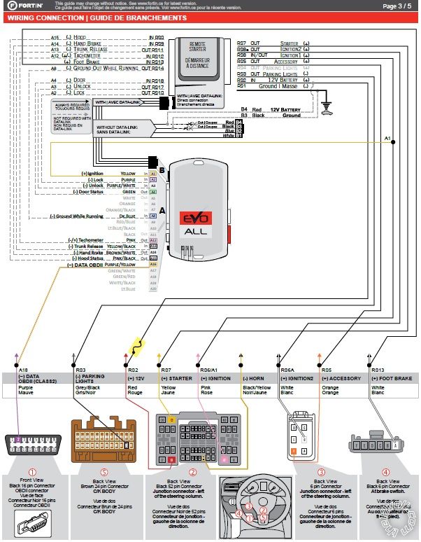

I recently bought sierra 3500 manual transmission diesel. I have viper 5706V with few sensors and fortin evo-all. according to fortin instruction,
the bypass is only for automatic transmission. How I can connect foot break input for fortin side and viper?
I am also wondering how I can do clutch bypass. Am I supposed to just use relay for clutch bypass using RS status output from viper as trigger the bypass?
I appreciate your help.

The Fortin EVO-ALL install diagram does not show all the required connections for a manual transmission install. Remember that you must run in Tach Mode to allow use of the Vipers MTS Mode. Also the Vipers Neutral Safety Input wire must be connected to the trucks Parking Brake wire. Test to see if the trucks rear doors are monitored by the alarm. You might have to manually connect to the rear doors.

Additionally, the EVO-ALL must be flashed with the latest firmware ( Ver 70.18 ). You can set the Viper to a fixed 15 second "Wait To Start" delay for the diesel engine.

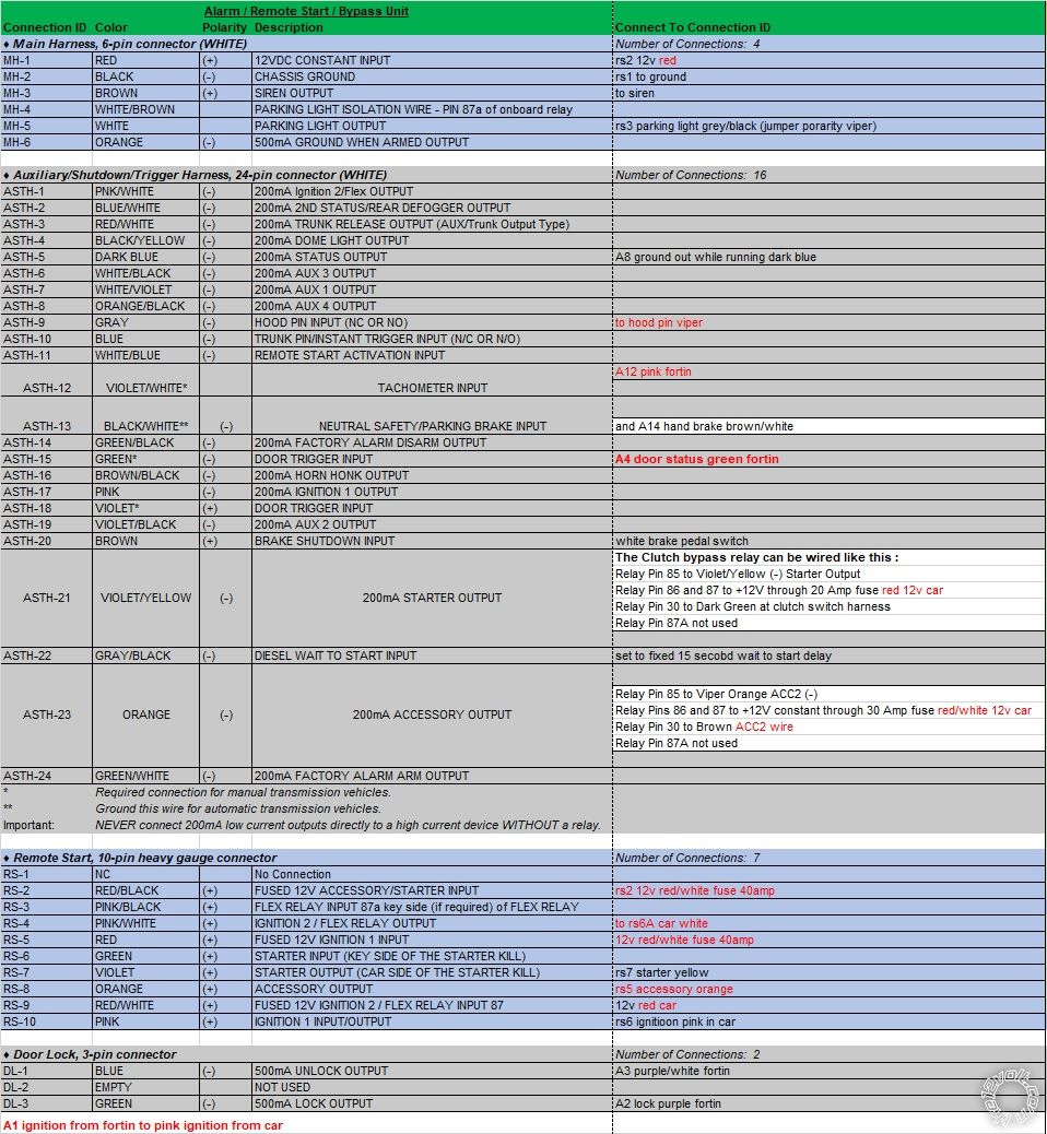

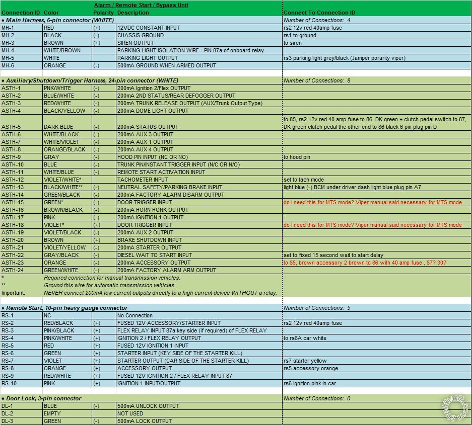

Posted: March 30, 2022 at 6:58 AM / IP Logged Link to Post Post Reply Quote gtitonta
I updated my wiring diagram excel sheet. I would appreciate a lot if you take a look for me.
I have a few question also.
1. The first one is that accessory 2 wiring. What do I need accessory 2 wiring? what is for?
2. according to viper manual, I need hook ash-15 and asth-18 for MTS mode. However, fortin instruction shows that fortin module cover door status. Does this mean I do not need to hook these two wires?
Thanks a lot!

Posted: March 30, 2022 at 9:00 AM / IP Logged Link to Post Post Reply Quote kreg357
Here is a link to a remote start install in a similar vehicle :
https://www.the12volt.com/installbay/forum_posts.asp?tid=133000
Of interest will be the two +12V constant wires in the ignition harness. You should split up you Viper power inputs between these two wires. Speaking of Viper +12V power inputs, there are four of them and they are all used for your install. Basically anything with a fuse gets power.
The EVO-ALL does not supply the vehicle Brake wire. Probably just an omission on your chart. ASTH-20 to White Brake wire at brake pedal switch.
The Brown ACC2 wire might not be necessary. Depending on the year it supplies power to various circuits. Some installers never use it. I always power it, just in case. The relay wiring goes like this :
Relay Pin 85 to Viper Orange ACC2 (-)
Relay Pins 86 and 87 to +12V constant through 30 Amp fuse
Relay Pin 30 to Brown ACC2 wire
Relay Pin 87A not used
The Clutch bypass relay can be wired like this :
Relay Pin 85 to Violet/Yellow (-) Starter Output
Relay Pin 86 and 87 to +12V through 20 Amp fuse
Relay Pin 30 to Dark Green at clutch switch harness
As for the Door Pin Inputs, the EVO-ALL might supply those signals. If you have a 4 door truck, you should test using the Viper alarm to verify that any door will trigger the alarm. Some bypass modules will only supply the front door pin signals. If this is the case with the EVO-ALL, you will have to hard wire those signals into the Vipers (-) Door Pin Input wire. Remember to diode isolate using 1N4001 diodes.
Left Rear Door Trigger     lt. blue/black (-)     BCM under driver dash, rear, violet 16 pin plug, pin A3
Right Rear Door Trigger     lt. green/black (-)     BCM under driver dash, rear, violet 16 pin plug, pin A2
I usually hardwire the Tach signal input to the White wire at the instrument cluster harness. More reliable than some bypass modules Tach Signal output.
Remember that if you want to go D2D between the Viper and the EVO-ALL you must select Option F3 during EVO-ALL flash to support DEI's D2D protocol.

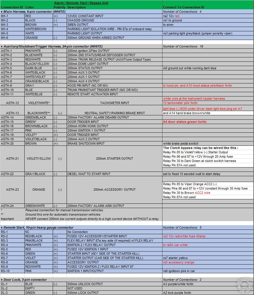

Posted: March 30, 2022 at 5:59 PM / IP Logged Link to Post Post Reply Quote gtitonta
hello again,
I flashed fortin bypass, and there was no d2d option now. So I flashed with w2w connection.
I added more wire connection in the excel file. I think that everything is correct, but could you double check my wiring?
Thanks again sicerely

Posted: March 30, 2022 at 7:08 PM / IP Logged Link to Post Post Reply Quote kreg357
Looking good. Confusing Wiring, 5706V and Fortin, 2005 GMC Sierra 3500 Diesel -- posted image.     Almost there. Some updates...
If your truck does not have a Factory installed hood pin, then the EVO-ALL will not be able to obtain and supply a Hood Pin output. The EVO-ALL Hodd Status signal at A15 is only an output. Therefore if you install the Viper kit supplied Hood Pin, only connect it to the Viper Hood Pin Input wire.
Same goes for the Tach Signal. If you go with the trucks Tach signal ( White wire at instrument cluster harness ) nothing will be connected to the EVO-ALL Tach Output wire ( not used ).
Ditto for the Parking Brake wire. However, if the EVO-ALL can supply that signal, you can just connect the Viper Neutral Safety Input wire to the EVO-All Handbrake Output wire and skip getting the signal at the BCM.
Still need to connect Viper RS-5 and RS-9 to +12V constant. Split between the Red and Red/White vehicle +12V power wires. The ACC2 relay power and the Clutch bypass relay power will come from these vehicle ignition harness power wires, too.
