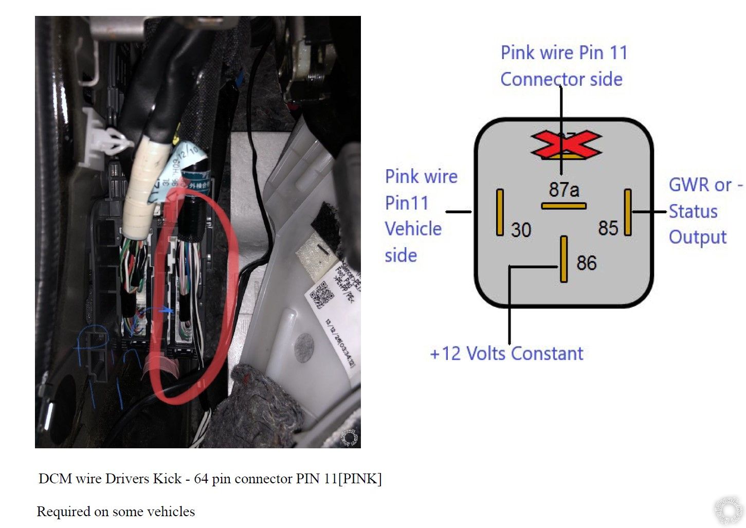

I have a 2015 rx350 that im installing a 4x10 into and it is not attempting to remote start. All wiring is correct and the module has been successfully programmed as I can unlock/lock doors, open trunk, and send the remote start command. However, during the remote start sequence the module starts flashing orange/red for a few seconds then flashes green a couple times but nothing happens with the car. This is a VERY easy install and have double checked and triple checked my wires. I believe it has something to do with the OEM remote start/ BCM enabled remote starter. On my 2014 lexus is350 that I installed the same remote start on I had the same issue and had to contact directed and they had me disable this DCM wire during the remote start sequence(see attached pic). Unfortunately, they are not open on the weekends. I pulled the MAYDAY/TELE fuse 7.5A under the hood and still nothing. Also checked behind the glove box for the physical remote start addon and that was not there. Beginning to think the 4x10 is faulty at this point. Does anyone have any information that might help me in this situation?

For those that care, which probably isnt anyone seeing as no one responded. There was a non oem remote start/bypass behind the passenger glovebox but not to the left where the oem one should be. Fired right up once i took this out.
