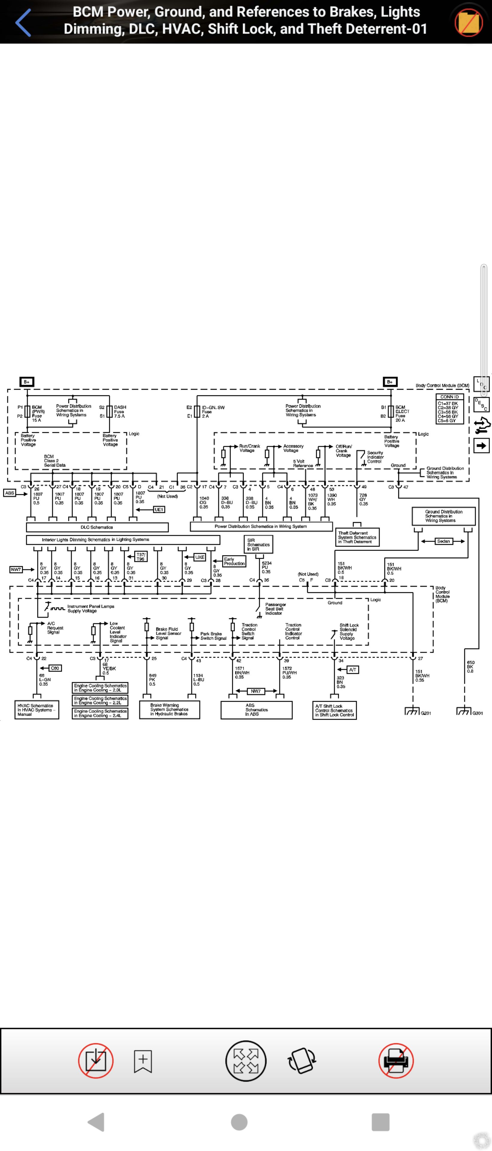

Posted: March 03, 2023 at 10:42 PM / IP Logged Link to Post Post Reply Quote miguelangelos
saturn ion 2006 the bcm connector c2 orange cables most of them are battery positive and it turns out that there is no power to any pin someone could help me solve that thanks

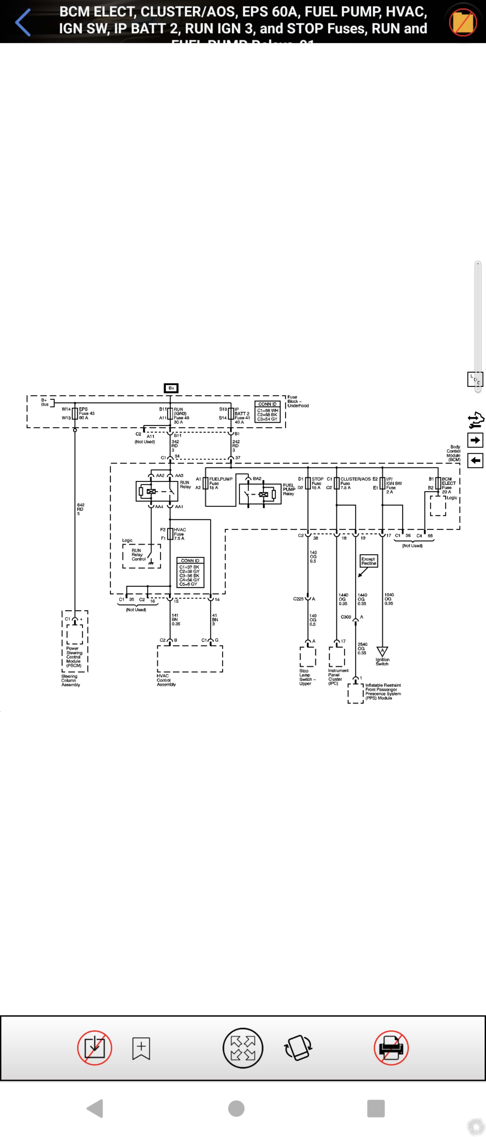

Posted: March 04, 2023 at 4:50 AM / IP Logged Link to Post Post Reply Quote geepherder
Check the 2 amp fuse at the BCM. 2006 Saturn Ion, Passlock 2 -- posted image.

geepherder
Platinum - Posts: 3,668
Joined: October 27, 2003
Posted: March 04, 2023 at 7:30 AM / IP Logged Link to Post Post Reply Quote geepherder
These all get power from the underhood fuse box fuse 41 (40 amp).
