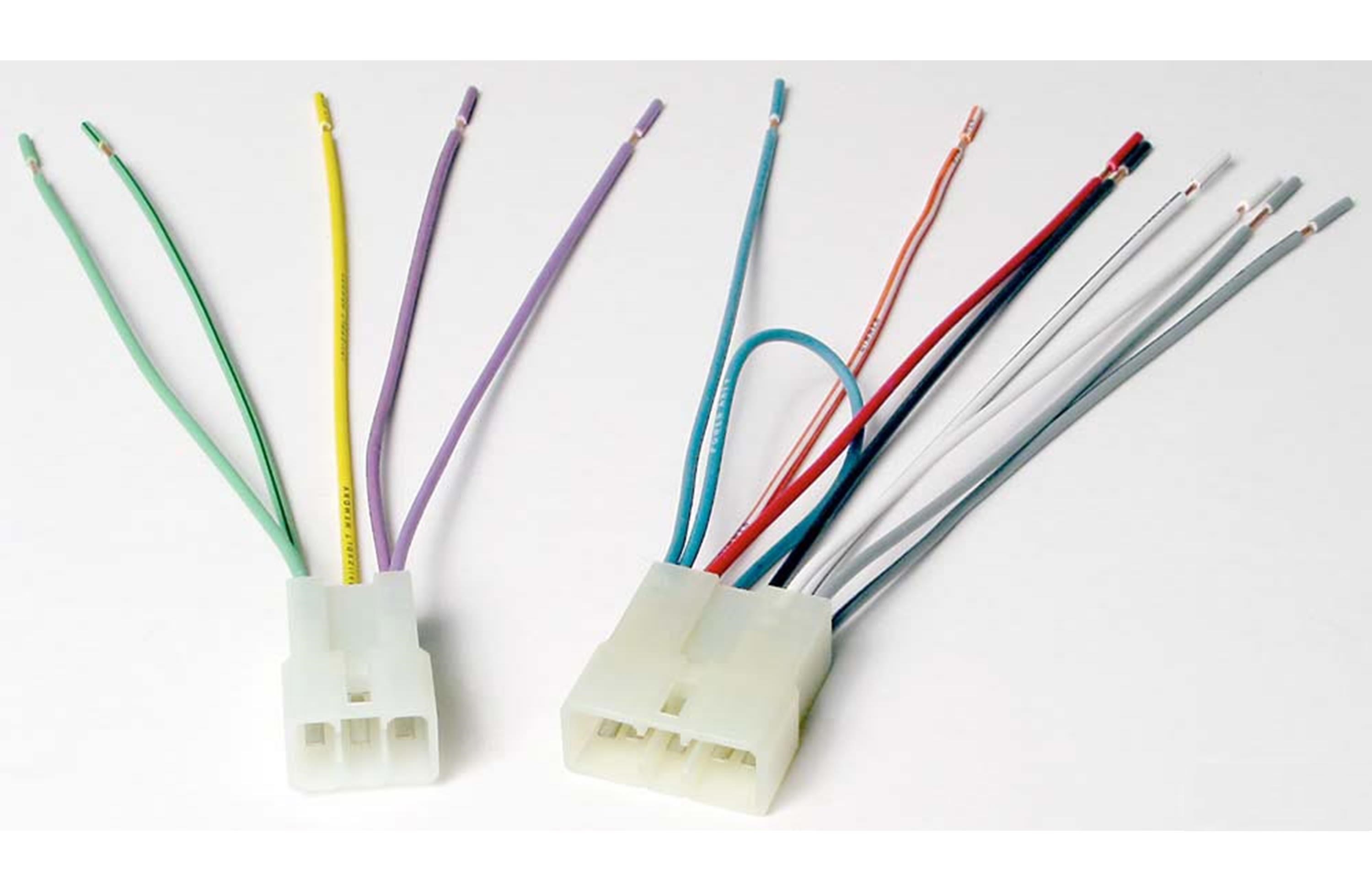

Metra has a harness adaptor and you can see that there are two blue wires off of the plug and both need to be powered off of the power antenna lead on the radio. Power Antenna Relay, 1990 Toyota Celica -- posted image. If the factory plug was cut off, then maybe you have an unused wire out of the car that is not connected to anything and this is the second antenna activation wire.

On the above post of mine, on a harness adaptor, the antenna activation wire is the blue wire and you can see how it's jumpered also to connect to a second wire in the cars harness.
