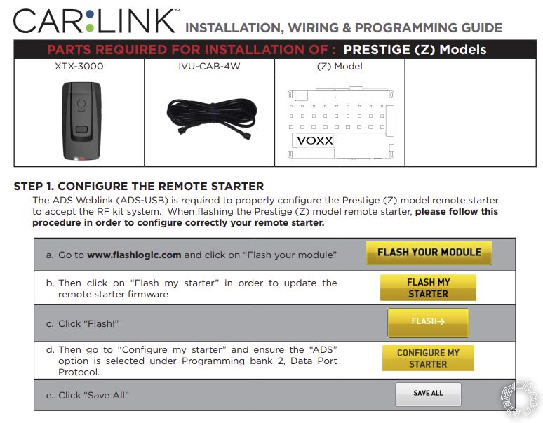

Im getting my rear end kicked here. I cannot manage to figure out how to enable telematics on weblink with this setup. I looked at the documentation with the carlink and it says I need to change the protocol, but weblink is only showing idata protocol, and when I get to the flash page where I can modify the telematics setting, it just brings me back to the firmware selection page. Anyone have any suggestions? I would greatly appreciate any assistance.
For reference this is going into a 2019 Subaru WRX STi with manual key.
The alarm/remote start has been in and working for a few months, just trying to add carlink.

Possible cause....?
Carlink ASCL6 Install On Prestige APS997Z -- posted image.

I actually figured it out literally minutes ago. The protocol setting it was taking about was actually within the CL6 app itself. Unfortunately I couldn’t manage to change it on Android, but on iOS I had to press and hold the protocol setting for 10 seconds to be able to change it to ADS and then it worked.
