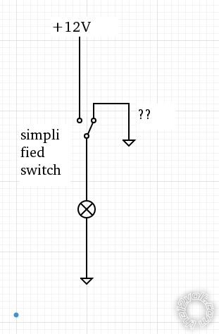

For any vehicle, am I guaranteed to have a chassis connection on the + side of a light bulb when it is *not* lit ?
I am particularly interested in the rear turn/brake light bulb.
Thanks

LED lamps not necessarily. Incandescent lamps, it will be very close to ground (Through the element(s) of the bulbs attached to the wire.

Just to clarify, I was referring to the GND connection marked "??". Is that "terminal" always grounded or can it also be left floating?
Thanks
Floating Versus Chassis Tied Light Relays In Off Position -- posted image.

It can be left floating. Chrysler at one time wired their parking light relays with the 87a terminal grounded.
